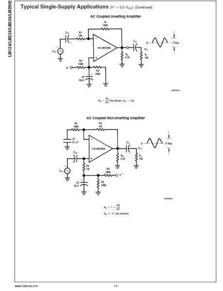

i would like to know, how does LM324 create a sine wave after the output of the op amp??

It doesn't. What are you asking about? An opamp does nothing on its own without some other circuitry...

Are you possibly thinking of how to ac couple the op amp? This is in it's datasheet.

https://www.calvin.edu/~pribeiro/courses/engr332/Handouts/oscillators.pdf
