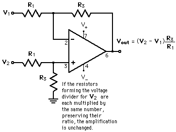

The other device I have is the USB 6009 DAQ that can ready +/- 10Vdc but it has limited resolution, if I hook the system up to the DAQ without conditioning the output signal I only get +/-5lbf output accuracy and that is when sampling at 1hz. I would like to maximize how fast I can sample and greatly improve the output accuracy. So I figure I need to "zero" the output voltage with a circuit and I suppose scale the output up to +/- 10V.
I hope I am not asking too complex of a question. I just don't really know where to begin. All I have come up with so far is:
-Low Noise Op-Amp to apply a GAIN to the output signal and power it with the DC voltage source
-Use a voltage divider circuit in parallel with the excitation source voltage to "zero" the output voltage.
I must not be doing any of it right though since the circuits I have thrown together from guides on the net have not done anything that I am wanting them to do :(.
Any help on where I need to look now?
Here is some other info on the load cell
Nominal Input Resistance: 394ohms
Nominal Output Resistance: 350ohms
Would an instrument amplifier with a setup such as the one posted in another PF topic work?
I suppose it is called a voltage difference amplifier. I suppose I could have one input voltage be my load cell output and have a 2nd power source of 5V which would give me an output of Vo = 0.65*A where A = R3/R1 and I could amplify the signal with a gain of about 14.5 which would give me Vo=9.425V nominal and Vo=9.86V FS (500lbf load).
Although I hear that I shouldn't be using an op-amp for a load cell amplifier. Instead I should be using an instrumentation amplifier. Can I perform a voltage difference amplifier with an Instrumentation amplifier as well??
You could use op-amps or instrument amps. Depends on your cell and what you want to do. e.g. how many varying elements, temperature compensation, linearizing.
I found this http://www.analog.com/static/imported-files/seminars_webcasts/49470200sscsect2.pdf" [Broken] that might help in you circuit design.
