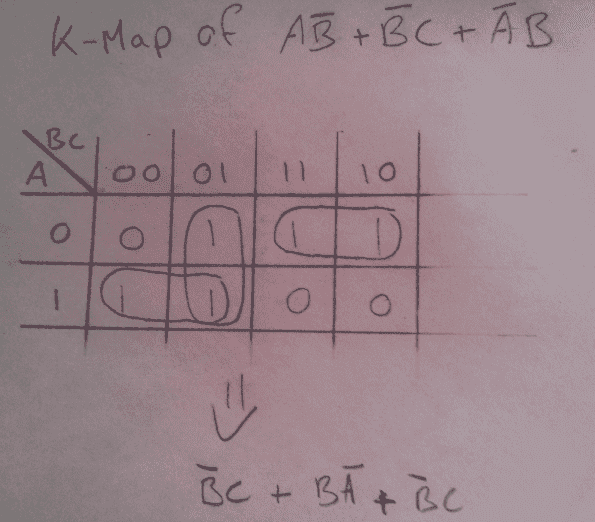

I have been asked to simplify this function: A/B + /BC + /AB I seriously can't seem to know how to simplify this as for me its already simplified.
N/A
The best I could do is : (/A+/B) * (A+B+C) I did this with Karnaugh and took the 0s rather than the 1s and got that.
You have not shown any work. Hard to help you see where you might be going wrong with just that.
Show your K-map, in stages as you add the effect of the terms

The F= A/B + /BC + /AB function is from this circuit:
http://i.minus.com/iPJFIP76kjJEK.PNG
karnaugh:
http://i.minus.com/ibayIGwjsNQpA6.PNG
In yellow: /A+/B
In black : A+B+C
I'm not interesting in seeing random K-maps, I want to see the K maps for the 3 elements in the problem statement (A/B + /BC + /AB). Certainly A+B+C has nothing to do with the problem statement. And it would be better if possible that you post them in this thread rather than linking to them.

Here is the K-Map. How can this be more simplified? I still get same thing.
K-Map image in next post.

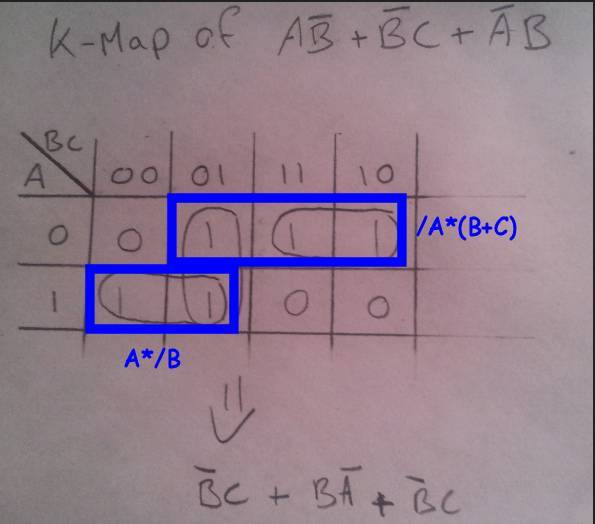

In terms of the number of gates and inverters required to implement it, and in terms of the number of variables required for an equivalent expression, a better expression would be A*/B + /A*(B+C)
It's not a huge reduction, but it is a reduction.

Can you please explain how you ended with A*/B + /A*(B+C) ?
I read the K-map.

My teacher told us only to make group of 2-4-8-16 etc. That a group of 3 is invalid. We probably haven't learned it yet.
OK, seems weird, but he may have had a specific reason for such a restriction, although I can't imagine what purpose it could serve since the real world certainly has no such restriction.
Despite what your teacher said, and despite any restrictions you may have to use in getting an answer to turn into him, I recommend that you get used to interpreting K-maps for minimal gate implementation.
