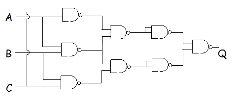

So, just for fun, why not complete it with just 2ip NANDs !
Takes me 7 NANDs (and maybe 2 minutes), but I don't use any DeMorgan or Boolean algebra, so there may well be shorter ways.
Why not! Could you show me your solution? I'm really not getting it!

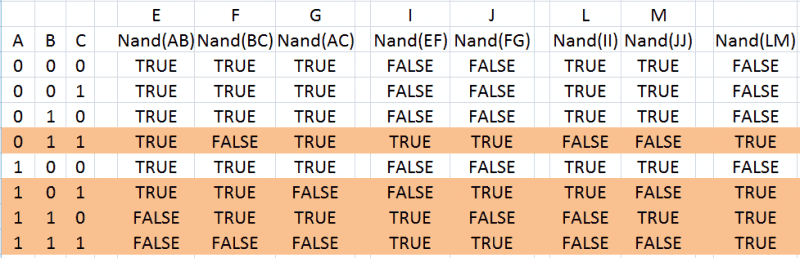

Ok. Of course, when I typed it up, I found an error and now it is 8 gates!
I've done a drawing and also an Excel spreadsheet which I think may be helpful.
Drawing is attached. I can't attach the Excel (AFAIK), but I've attached a screenshot.
My thinking was, the first level of nands will be low if both inputs are true, so I need any of the outputs to be low.
Second layer, if all inputs are high, output will be low, so I need either of them to output high, showing an input was low.
Now is where I made my error and had to correct it by inverting these outputs.
If I invert them, then I need either inverted output to be low.
The final nand is high unless both its inputs are high, so it is high if either input is low.
I know that is probably confusing! It's hard to explain my thinking process.
1 - I just believed it must be possible
2 - 3 inputs mean 3 pairs so 3 nands. That gives me signals showing a pair of 1's
3 - I've got to get it down to 2, so try combining with just 2 nands and see what I get
4 - Now I've got a 1 if any of the pairs was good.
5 - Nand is no use to spot a single 1, so invert them to spot a single 0
6 - Final nand is high if either input is 0.
Final bit of info. I tried to do an LTspice circuit of this, but could not manage that(!), so I went to my old friend Excel. The screen I show is the result. AB&C are the inputs, E,F&G are the first level Nands and so on.
So the formula in column E is =Not(And(Ax,Bx)) using Not(And) because there is no Nand.
Column I is =Not(And(Ex,Fx))
Column L is = Not(And(Ix,Ix)) just to show I'm not cheating! I could have simply put = Not(Ix)
And final column O is =Not(And(Lx,Mx))
I have highlighted the rows which should give a True (1) output.
No doubt the methods taught in your course are better and I do use some of them sometimes. But I really like to see what is going on, if I can. The comment someone made about using LTspice is probably very good advice. Make up circuits in whatever modelling system you can (even Excel!) and play around.
