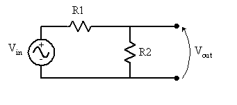

The schematic shows a low-pass filter identical to the one you built in studio. This filter uses a 60 k
resistor and a 250 pF capacitor, and the input signal is at 30 kHz. (1 pF=10−12 F).
http://loncapa.mines.edu/res/csm/csmphyslib/P200_Materials/TestBank/AC_Circuits/LowPassFilter.jpg [Broken]
What is the signal gain? Remember, gain means the ratio of the output voltage (the voltage across some indicated component) to the input voltage (the voltage of the power supply).
Nothing we've ever learned let's us compare voltage without knowing current. If it helps, the reactance is 2.12×104 Ohm. I can't use V=IZ, C=Q/V, everything equation we've been taught can not be used because we're missing information.

Assuming that the image will display a voltage divider scenario, suppose that the two components were resistors (say R1 and R2). What would be the output voltage expression?
R1 + R2? So basically (reactance + resistance)^2 + (reactance)^2 then square rooted? And that's the output voltage? My ratio ended up being 1.32 . . . aka wrong =( (and 0.782, the voltages reversed, was also wrong).

No no no. I'm asking you if you know what the voltage divider equation looks like for just resistors.
Oh. No. This is the first time I've ever heard anything about voltage dividers (and googling it didn't bring up many simple, easy to follow websites).

I find it hard to fathom that you're being introduced to AC reactances without first being given the foundation of resistor circuits. You can't write the expression for Vout for the following circuit?
I've never seen that before in my life.
Maybe I'm jumping ahead (we still have like, 1-2 lectures before the exam depending on if ones a review), but yeah, we've never done anything like that.

If no voltage was specified for the source then just assign a variable to it. Call it Vin or whatever your choice is. Your results will then be symbolic and will contain that variable.
Going back to the purely resistive voltage divider that I depicted in post #14, how would you find the output voltage, Vout? You can use Kichhoff and Ohm's law.
Wow. This explains why this problem was angering me so much.
I was using all the information I've been given to get the correct answer. They just wouldn't accept 0.24, no, they needed 0.245 in order for it to be correct (I've done it multiple times with different number sets).
