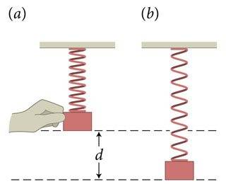

What is the maximum distance traveled by the block in a vertical spring system?
In summary, the hand in (Figure 1) compresses a vertical block-spring system so that the spring is compressed. When the hand lets go, the block, of mass 2m, descends a distance 2d in a time interval Δt before reversing direction in (Figure 1) (b). Once the system comes to rest, the block is removed, and a block of mass m is hung in its place.

The hand in (Figure 1) (a) holds a vertical block-spring system so that the spring is compressed. When the hand let's go, the block, of mass m, descends a distance d in a time interval Δt before reversing direction in
(Figure 1) (b). Once the system comes to rest, the block is removed, a block of mass 2m is hung in its place, and the experiment is repeated.
to what maximum distance does the block descend?
Express your answer in terms of π, acceleration due to gravity g, some or all of the variables m, d, and Δt.

You have no information regarding xeq. For each mass, you have an initial state in which the spring is partially compressed, and a later state in which the mass is at its lowest point.
Create an unknown for the initial compression and see what equations you can obtain.
Hmm. The problem says:
You should be able to conclude some things about the amplitude of the motion, the new equilibrium point for that motion, and the period of the oscillations. An expression for the spring constant might not be out of the question...

If you consider the symmetry of a mass/spring oscillation, the mass always oscillates symmetrically about an equilibrium point. That equilibrium point is identical to the point the mass would hang at rest under the influence of gravity.
So given that the mass is released the first time and falls a total distance d from the point of release before stopping and turning around to return, you should be able to locate the new equilibrium point below the release point using that symmetry.
You should also be able to determine the period of the oscillation from that fall, which is what portion of a full cycle?
With the period and mass you should be able to find an expression for the spring constant.

If you're using the distance d, as it is shown in the picture, that will be twice the amplitude A.
Let me start by saying I haven't worked out the problem with any equations or numbers. But I think you are forgetting that it starts out compressed.
The equilibrium position, as measured from the spring's natural length, will be doubled. But since the spring does not start out at it's natural length (it starts out compressed) this will not correspond to D=2d.
Call the natural length Ln and call the compressed length that it starts out at is L0 (compressed meaning L0 < Ln)
From what I said above (the equilibrium point as measured from Ln is twice for the mass 2m) we can write the equation:
(L0+D/2-Ln) / (L0+d/2-Ln) = 2
So to conclude that D=2d means to me that you assumed L0 = Ln

Seems to me it will be 2A. Maybe we're reading the problem differently.
I see in post #9 you felt the problem was ambiguous. I think it's clear there are two separate experiments. What is a bit confusing is the reference to the system coming to rest. That appears to be irrelevant.
I read it as being the "launch" point of the new experiment. The mass 2m is released from the equilibrium point of the previous mass m.

I don't see why that stops d being twice the amplitude. The relevant fact is that the KE is zero at both positions. Since there's no loss of energy (we assume), it must keep returning to its launch position.
Hmm... maybe, but I still read "experiment is repeated" as meaning it is raised as before. Otherwise, you could even read it as the 2m block being released from its own equilibrium position (leading to a rather trivial answer).

d is 2A regardless. Like gneill pointed out, there's a certain symmetry with SHM: the oscillation is around the equilibrium point.
This means it goes as far below equilibrium as it goes above, which means the equilibrium point will always be half way between it's highest and lowest points (assuming energy is conserved).

starting to think A might be constant with xeq being the only thing that changes, but that can't be true, need to get into this with paper and pencil for a minute...tick tock
be back soon as possible, will re-read problem and posts and if necessary the end of chapter 15, see if I get anywhere
xi is the starting point? Measured from the equilibrium position? This means xi = d/2 which gives us nothing new... Have you considered taking the spring's relaxed length as the origin?
Jediknight said:
but that would make xi=A, but that would make the energy at the tp greater than the energy at the bottom
I think you're not seeing that the object does not rise as far above the relaxed length as it falls below it. You can't even write any equations to check the energy without introducing another unknown (the initial compression).
Jediknight said:
but where does that gravitational potential energy go?
You have to remember, the spring-potential-energy depends on the spring's relaxed length. But the block does not oscillate about the spring's relaxed length... It oscillates about the equilibrium position which is below the relaxed length. So the system has more spring-potential-energy at the bottom than at the top, and it has more gravitational-potential-energy at the top than at the bottom.
Anyway, I don't think you need to use energy to solve this. (But it is good to understand that energy is conserved and how.)
Use the pencil to draw a picture of the situation. Use the relaxed length as the origin. Include the initial compression as an unknown. Sometimes equations can make things a little foggy, it is important when solving a problem to have a clear idea as to what you're trying to do and (ideally) what's stopping you.
calling A (d/2) gave me some contradictions but maybe I was just getting jammed up,
starting over with xrelaxed as the origin, that makes xi the same value in both problems, but that also means xi≠A, but as you said that doesn't help us anyway
-Starting with a cos function this time, as it seems to start at the amplitude (i.e. xi-xeq=A)
What does xi represent? Please say explicitly.
Also, are you working under gneill's understanding of the problem statement, in which the second block is released from the bottom point of the first block's motion?
A is a distance, xi is a position. Whether they're equal depends on your reference point for positions, which you've not defined.
xi=the value given to the starting point based on the choice of origin, thinking about it your way, which I'm thinking is best but still struggling, xi will be the same value for both set ups, but xiA in this frame xi-xeq=A , and xeq2=2xeq1 [(also this means x at time t or x≠Acos(ω(t), but x-xeq does) (but ill have to be careful of my signs during using these as choosing "up" as my positive axis makes xeq a negative value)]
I think the problems saying the point of release (xi) will be a fixed distance from a fixed point (say the ceiling) I think they would've drawn 2 pictures if that wasn't the case, I think there reason for saying experiment was repeated is just so they can avoid saying "Identical" so many times to describe the spring and elevation of experiment.
I know the "hung in its place" is a little vague, but honestly I don't care about getting the problem r"ight" is long as I figure out the correct answer with respect to the interpretation being followed, if both versions of the problem are possible I'd like to go at the harder one. I just know as hard as this seems for me my test tomorrow will have one 20X harder with something I couldn't expect or predict thrown in (they always do) I'm just trying to get an understanding, and if I understood this stuff I'd understand how to solve the problem (with either interpretation I do believe)
I think d is the distance from that fixed point of release (xi) the object travels before turning around, and I think the time it takes for object 2 to do it will be Δt√(2) due to the fact ω^2=k/m and ω(t)=π when object is at its lowest position
  • #31
at that time I was calling xeq the origin, but I think calling xrelaxed of spring without masses (which I would now like to denote as x0 If its ok with everybody) the origin will give me some more insight to this problem, as was suggested
  • #32
Jediknight said:
xeq2=2xeq1
Again, that is not meaningful unless you state where your origin is. For that specific statement to be true, your origin would have to be the bottom of the relaxed spring. I feel that this confusion between absolute and relative positions is a key part of your difficulties.
Ok, that post crossed with yours, defining the origin as the bottom of the relaxed spring.
  • #33
Ok, with that definition, all of your post #30 looks right. So, how about some equations?
  • #34
I just wanted to say real quick THANK YOU ALL FOR PUTTING UP WITH ME SO FAR I should've defined variables better and specified reference frames better from the start, I'm new here and will do better next time and I think just thinking about that is an improvement to my problem solving skills SORRY I DIDN'T DEFINE THINGS BETTER SOONER
now ill check that last alert, but I probably won't respond til I go get my head around all this again, again thank you guys, I'm really trying here
I'm also happy to "give up" and get there correct answer if it will help in understanding how to get to it/defining what the problem was actually asking (my HW is a very low percentage of my grade, all its really therefor is understanding the material)
  • #35
ok that didn't work, be back more organized without typo's don't have time to figure out how to fix that now, it looked good before I hit post
