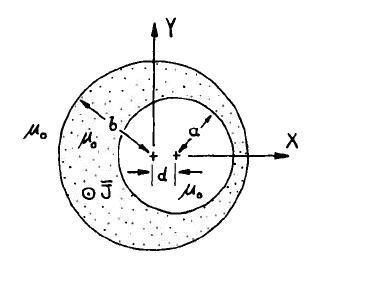

An arbitrarily long hallow cylindrical electric conductor shown carries a static electric current density J=[tex]\hat{z}[/tex]J0. Determine the magnetic flux density B in the hallow region of radius a. Your result should show that B is constant in this region.
∫B.dl = µ0I
current I = [tex]\hat{z}[/tex]J0pi(b2-a2)
B. 2pia = µ0 [tex]\hat{z}[/tex]J0pi(b2-a2)
B = µ0 [tex]\hat{z}[/tex]J0(b2-a2) /2a
I am not sure about B.dl being B.2pi a

Utilize the relation
[tex]\vec{B}=\frac{\mu_0\vec{J}\times\vec{r}}{2}[/tex]
and approach the problem with a uniform current distribution throughout the circle of radius b, plus a current in the opposite direction in the hole.
I am trying to do exactly that: +J current density in b and -J in region of radius a.
Add both to get result. But in the equation you mentioned, how to calculate the cross product.
seems a bit complicated. Can't I use just ∫B.dl = µ0I
Superposition of B within the hollow region:
[tex]\vec{B}=\vec{B_b}+\vec{B_a}[/tex]
[tex]\vec{B}=\frac{\mu_0\vec{J}\times(\vec{r_b}-\vec{r_a})}{2}[/tex]
So, what is
[tex]\vec{r_b}-\vec{r_a}[/tex]
equivalent to?
ddddddddddddddddddddddddddddddd.
Can't believe I missed it.
I shall go shoot myself in the foot.
Before I do that, can you tell me how to solve Jxr for a single sphere problem.
Just do the cross product or is there some trick?
