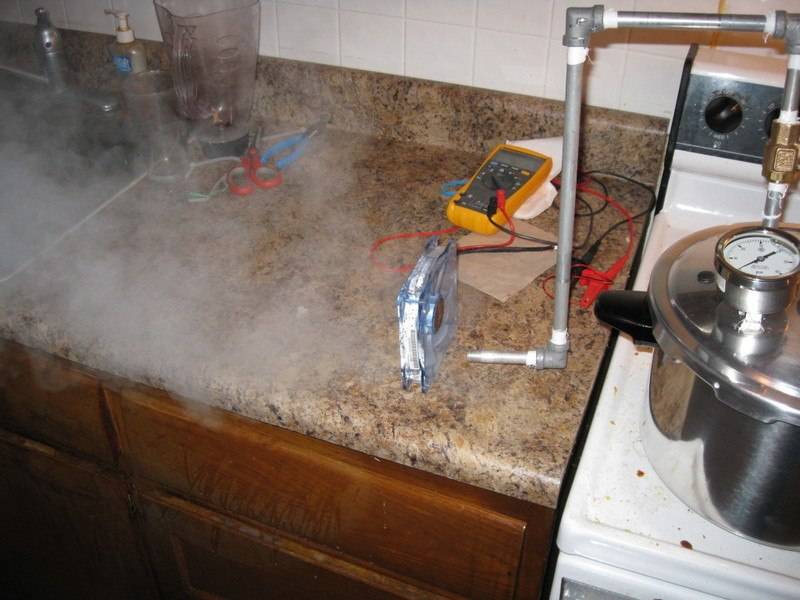

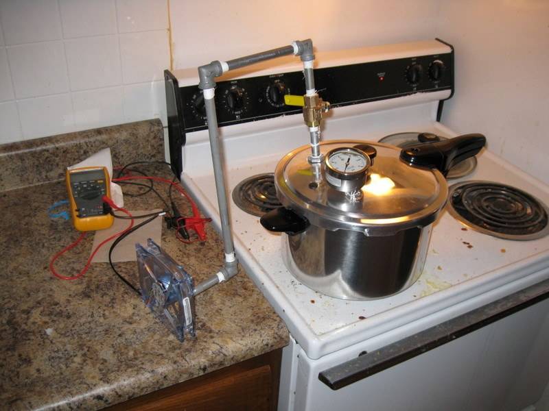

If you were my neighbor, this morning at 6am you would have heard loud, celebratory swearing through your wall. I read 6V off my multi-meter with this:

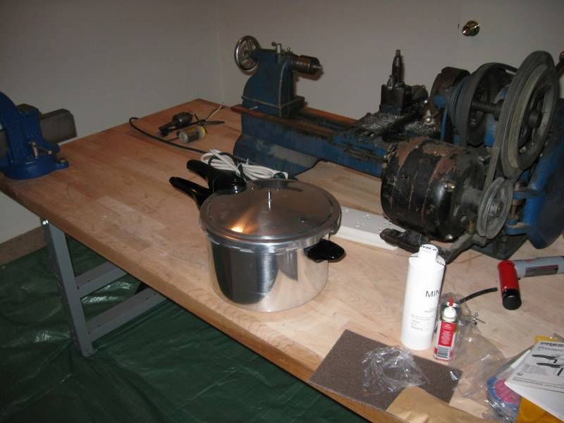

I started with an unsuspecting aluminum pressure cooker:
I tapped two ¼” NPT holes in the top—one for a pressure gauge and one for the piping system I made.
When I read 13 PSI on the pressure gauge, I released the steam.
Next up is:

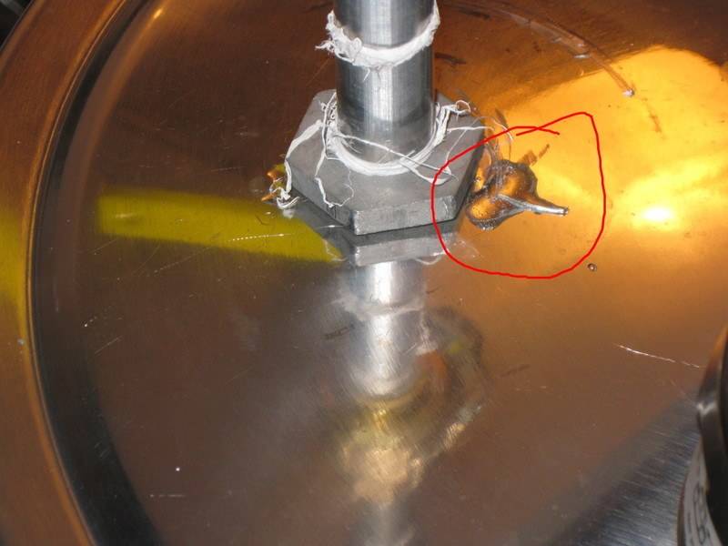

The seal between my piping system and the pressure cooker lid is poor. I had 14 PSI before installing the pipe and 13 PSI afterwards. The lid is only 0.08” thick, so it was easy to strip the thread two or three threads I was able to tap. I used pipe nuts as a stop gap, but I think some gasketing would help. Any advice? You can see steam escaping in this picture:

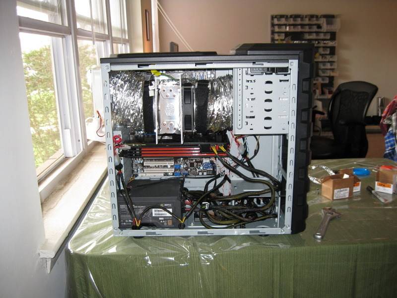

I would like to encase the fan. I was thinking about something like what I used on my PC (see below). The challenge is that I can’t figure out how to adapt from ¼” NPT to 5” diameter duct.
