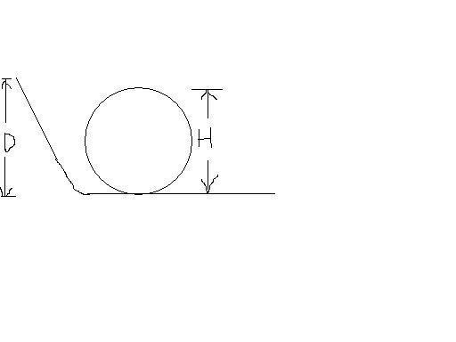

A popular pastime used to be to construct helter-skelters: tracks along which to
roll (without slipping) a ball (a marble say, or ball bearing). I made one that mimics a
fairground loop-the-loop (see attached .jpg). If the drop from start to base of the loop is D, and the top of the loop is a height H above the bottom, then what is the largest theoretically
possible value for H/D?
?? - I am very confused.
Also, if my picture is bad, the height D is obviously supposed to be larger than the height H.
Thanks in advanced

Welcome to the PF. The easiest way to solve this type of problem is to use energy considerations. When the ball is at the top of the D ramp, it has all potential energy (PE) and no kinetic energy (KE) because it is not rolling yet. Are you familiar with how to calculate the PE of an object of mass m raised by some height D?
At the bottom of the ramp, the ball has all KE, although part of that KE is from its linear motion (what is the equation for KE as a function of an object's mass and velocity?), and part is from its rotation (are you familiar with a ball's Moment of Inertia and the energy associated with rolling?).
At the top of the loop, the ball has to be moving fast enough not to fall off the track. Are you familiar with how to figure that out?

@topgun08: Think of my hint :wink: The key is the normal force. The energy conservation law is just for calculating speed.

Okay here is what I have After checking out the equations and realizing what your normal force hint was all about.
PEtotal=mgD
KEat any point = .5mv2 + .5Iw2
Using the known formulas for a sphere's moment of inertia and for angular acceleration...
I = 2/5mr2
w = v/r
I substitute these formulas into my KE equation and compute:
KE = .5mv2 + .5(2/5mr2)(v/r)2
KE = .5mv2 + .2mv2
KE = .7mv2
Now once inside the loop-the-loop the marble will have centripetal acceleration. For this problem we want the normal force at the top of the loop-the-loop to be 0. So the only force acting on it will be the centripetal force whose acceleration is equal to gravity's acceleration. Thus the Fc = mac where ac = g
Using the formula that ac = v2/R where R is the radius of the loop-the-loop, I can solve for v2
ac = g = v2/R ==> v2 = Rg
Plug this back into the KE equation:
KE = .7mv2
v2 = Rg
KE = .7mRg
Applying the conservation of Energy Law at the top of the loop-the-loop:
PEtotal = KEtop + PEtop
mgD = .7mRg + mgH
Realize that H = 2R
D = .7R + 2R
D = 2.7R
(1/2.7)D = R
.74 = 2R/D
.74 = H/D
Is my logic and math right? Any mistakes or is this correct?
It's correct :wink:
