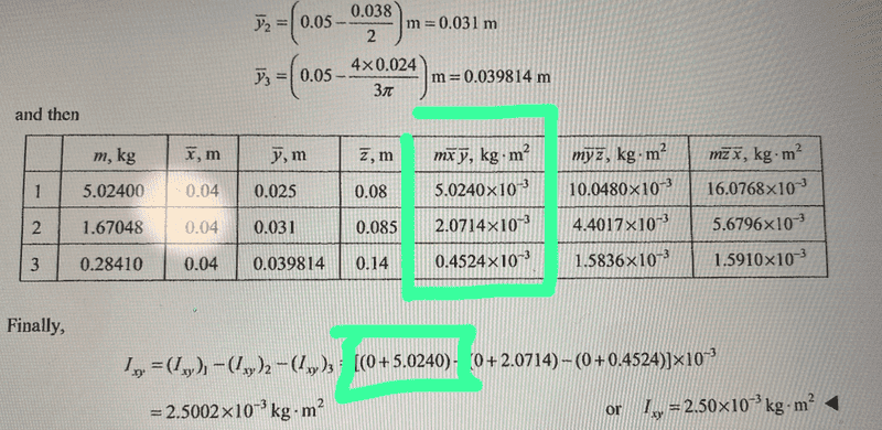

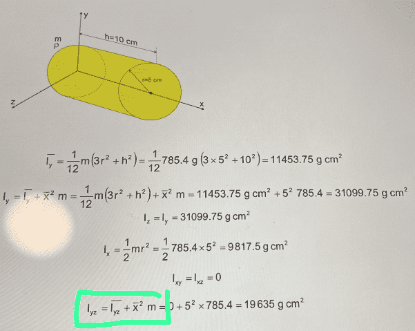

How is the mass inertia product calculated? I have two examples and each one uses something different.
Example 1:
Example 2: moments and product of inertia of the cylinder
What is the shape and orientation of Example 1?
That's it, I got it, thank you!
