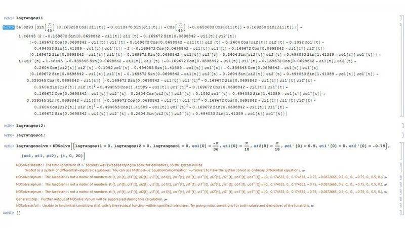

i recently used NDSolve for a system with three second-order equations but it says:
"NDSolve::ndsdtc:
("\"The time constraint of 1.` seconds was exceeded trying to solve for derivatives, so the system will be treated as a system of differential-algebraic equations. You can use Method->{\\\"EquationSimplification\\\"->\\\"Solve\\\"} to have the system solved as ordinary differential equations."
whats the problem? can anyone help me soon?! i can't give answer even if i change the Method or using DSolve instead NDSolve... :(
It sounds like the equations that you have are not in the form of a derivative on the left and a function on the right. It looks like Mathematica is having trouble trying to put it in that form.
Can you post the code that is generating this error?

the code is :
Ugh, I cannot do anything with a blurry picture of code. Please post the code, not a picture of the code. I need enough code to be able to replicate the error here.
Ok but because of containing special characters,you must copy the code into your own Mathematica to see it correctly...
Code:

lagrangesolve =
 NDSolve[{lagrange\[CurlyPhi]i1 == 0, lagrange\[CurlyPhi]i2 == 0,
   lagrange\[CurlyPhi]o1 == 0, \[CurlyPhi]o1[0] == -\[Pi]/
    36, \[CurlyPhi]i1[0] == \[Pi]/18, \[CurlyPhi]i2[0] == \[Pi]/
    18, \[CurlyPhi]o1'[0] == 0.5, \[CurlyPhi]i1'[0] ==
    0, \[CurlyPhi]i2'[
     0] == -0.75}, {\[CurlyPhi]o1, \[CurlyPhi]i1, \[CurlyPhi]i2}, {t,
   0, 100}]
thanks for your consideration...

MaxSteps -> 100000];
For[\[Tau] = 1, \[Tau] <
251, \[Tau]++, \[Theta]t = \[Theta][\[Tau]/50] /.
equ; \[CurlyPhi]t = \[CurlyPhi][\[Tau]/50] /. equ;
If[2.00 \[Theta]t[[1]] < \[CurlyPhi]t[[1]] <
1.90 \[Theta]t[[1]] && \[Theta]t[[1]] < 0,
time = (FindRoot[(2 \[Theta][t] == \[CurlyPhi][t]) /.
equ, {t, (\[Tau]/50)}]); time = t /. time;
If[0 < time <
5, \[Theta]t = \[Theta][time] /.
equ; \[CurlyPhi]t = \[CurlyPhi][time] /. equ; Break[],
time = 0.25; \[Theta]t = \[Theta][time] /.
equ; \[CurlyPhi]t = \[CurlyPhi][time] /. equ;],
equ; \[CurlyPhi]t = \[CurlyPhi][time] /. equ;]];
time
If[2 \[Theta]t == \[CurlyPhi]t, \[Theta]t = \[Theta][time] /.
equ; \[Theta]dott = \[Theta]'[time] /.
equ; \[CurlyPhi]dott = \[CurlyPhi]'[time] /. equ;
array = Append[
array, {i, j, k, l,
time, \[Theta]t[[1]], \[CurlyPhi]t[[1]], \[Theta]dott[[
1]], \[CurlyPhi]dott[[1]]}]; o = o + 1;]
\[Theta]t
\[CurlyPhi]t
\[Theta]dott
\[CurlyPhi]dott
o
as you see , FindRoot can not find any answer even though it has...!
the error is :
InterpolatingFunction::dmval: Input value {7.33381} lies outside the range of data in the interpolating function. Extrapolation will be used. >>
InterpolatingFunction::dmval: Input value {-3.67762} lies outside the range of data in the interpolating function. Extrapolation will be used. >>
The line search decreased the step size to within tolerance specified \
by AccuracyGoal and PrecisionGoal but was unable to find a sufficient \
decrease in the merit function. You may need more than MachinePrecision digits of working precision to meet these \
tolerances. >>
note that it gives me an answer " {t -> 2.32069} " but this answer does not satisfy my conditions(equality) and for this, o does not change as we expect.
i completely confused !
i don't know what this error means(i know its definition but also know no number lies out of the range in my code) and why occurs. have you any idea for this problem?
It looks to me like Mathematica is correct. It does not have a root. After the call to NDSolve run this:
Plot[(2 \[Theta][t] - \[CurlyPhi][t]) /. equ, {t, 0, 5}]
and then
FindMaximum[(2 \[Theta][t] - \[CurlyPhi][t]) /. equ, {t, 2.5}]
You see that it gets close to 0, but does not actually reach 0. The equation does not have a root in the range 0 to 5.
yes but my problem is not about having solution or not, the problem is the error:
nowhere in my code "t" lies out of the range. my t range is 0 to 5. why FindRoot goes and checks 7.33381 that is out of range...?
thank for your concentration
You didn't tell FindRoot not to. You used the call:
FindRoot[lhs==rhs,{x,x0}]
That tells FindRoot to start at x0 but doesn't tell it to stop anywhere.
FindRoot does not know that your equation uses InterpolatingFunctions, and so it has no reason to suspect that it is not valid outside of some range. So it will ask the interpolating functions for values at t=7.33 etc. The InterpolatingFunction object will return a value, which FindRoot has no reason to suspect. The InterpolatingFunction object warns you directly that it has done so, but since it provides a value the processing for FindRoot continues.
If you want FindRoot to stop outside of a range then you must use:
FindRoot[lhs==rhs,{x,x0,xMin,xMax}]
i didnt know it...
Thanks for your good informations
