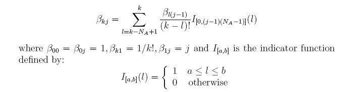

Hello,
I have the following equation, and I want to program it using MATLAB. But it is a recursive function, and it seems that I can not handle it well. So please if anyone can help, I will be thankful.
I would suggest you create a 2D matrix of size k (whatever that happens to be / you choose it to be--maybe this is a parameter that your function takes in?), seed the initial values given, and then make copious use of the for or while loops in MATLAB:
http://www.mathworks.com/access/helpdesk/help/techdoc/learn_matlab/f4-1931.html#brbsthm
http://www.mathworks.com/access/helpdesk/help/techdoc/learn_matlab/f4-1931.html#brbstiw-1
