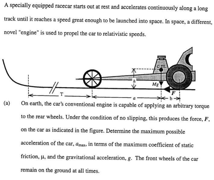

In summary, the problem involves a car with two wheels, with a torque being applied to the rear wheel and the front wheel only supporting the weight of the car. To find the acceleration, the free body diagram can be used to set up equations for the forces and moments acting on the car. The coefficient of friction for the front wheel does not matter. The "rolling without slipping" condition means that only the static friction coefficient is used. The acceleration can be found by solving for the unknown normal force at the front wheel and using the equation F = MA. There may also be a fictitious force, MA, acting at the center of mass due to the non-inertial frame of the car.

Denoting the forces at the back wheel with a 1 and front wheel with a 2 and calculating the torques around the CoM I have
$$F-f_1-f_2 = mA$$
$$N_1 + N_2 -mg = 0$$
$$hf_1 + h_f2 - hF +bN_1-aN_2=0$$
with $$f_i = \mu_i N_i$$
So just using this I can't seem to solve for A in terms of mu and g. I have some questions though, is mu the same for both wheels? The also mentions "rolling without slipping", am I meant I incorporate this somehow?, it doesn't give any explicit info and moments of inertias of the wheels so I don't see how.

The torque is applied to the rear wheels only and the resultant force of that torque is ##F##. By definition, the force ##F## is also the friction force reacting to that torque. There is nothing on the front wheels other than the normal reaction to the weight ##Mg##.

If the back wheel tries to accelerate too fast, the front wheel will go up (see motorbikes doing that, or drag races going wrong). What is the acceleration where this happens? Does the back wheel have enough friction to support this acceleration?

Yes. You are asked to find the acceleration. The only unknown is ##N_1##. Solve the free body diagram to find it as a function of ##\mu## and ##A##.

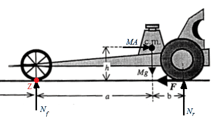

You know that ##Mg## is based on an acceleration? And you included it in your moment analysis? So why not include ##MA## as well?
The following is the free body diagram, Do ##\sum F_x##, ##\sum F_y## and ##\sum M## about point ##Z##:

Depending on the axis of rotation you choose to use, you can make one or more forces irrelevant. @jack action appears to be assuming an axis of rotation at the point of contact of the front wheel on the ground. [Not the choice I would have made, but it's viable]. With that axis of rotation in mind one has yet another choice...
1. Assume an inertial frame and note that the angular momentum of the race car is increasing in the counter-clockwise direction as the car accelerates leftward. [Note: key point about angular momentum -- it's not always about rotation!]
2. Assume an accelerating frame and note that the angular momentum of the race car is now constant but that there is a fictitious rightward inertial force acting on the center-of-mass of the race car.
@jack action has chosen option 2. Option 1 is equally viable.
Either way, there is still a net torque from the upward supporting force on the rear wheel and the downward force from gravity. Either way, the choice of rotation axis has made the frictional force of road on tire irrelevant to the angular momentum balance.
Or... choose the axis of rotation at the contact point on the rear wheel. Now you can ignore the supporting force from road on tire.
Or... choose an axis at the center of mass. Now the angular momentum is constant regardless of reference frame choice. But now the frictional force of road on tire becomes relevant.
Any choice will work and the analysis can proceed. But one needs to make a choice and see how the forces on the free body diagram work with that choice.

But that is the force we are looking for, why would we want to ignore it? The one we do not care about is the supporting force from road on front tire ##N_f##. With point ##Z##, both ##N_f## and ##F## are ignored, leaving us with ##MA##, ##Mg## and ##N_r##. You actually find ##N_r## with one equation (which should take less than 2 days to solve!).
jack action said:
The one we do not care about is the supporting force from road on front tire Nf
That's not entirely true. You need to use that this cannot be negative.
We are (or should be) looking for the condition where the front wheel is about to lift off the ground. In that condition, the entire weight of the car is supported by the normal force of road on rear wheels. One can determine that force, ##N_r## easily without writing down an equation for angular momentum.
At the condition where the front wheels are about to lift off the road, ##N_f## is already known to be zero. Accordingly, it does not contribute to the angular momentum balance. Choosing an axis of rotation at point Z under the front wheels causes one term to drop out of the angular momentum balance. But it is the term associated with N_f which is already known to be zero. There is no point in eliminating a term that is already zero.
