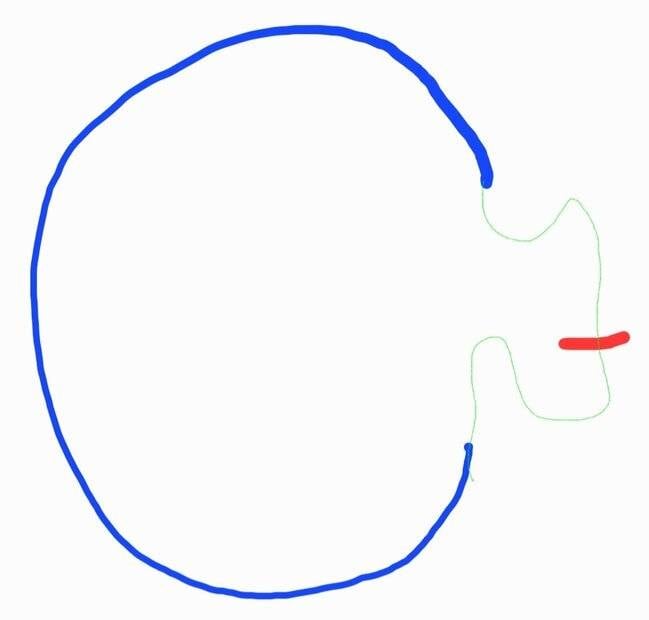

I am reasonably convinced that the setup is as follows. We have a small toroidal magnet (shown from the side as a red line). We have a piece of wire curved into a C shape (blue). We can always draw an infinite number of arbitrary imaginary lines that connect the ends of the wire and pass through the hole in the toroid (one such is shown as a fine green line).
The blue and green lines together form the perimeter of a surface ##\Sigma## through which one side of the magnet passes.
I think that the relevant analysis is this: we can always choose an arbitrary green line arbitrarily close to the edge of the magnet. Thus any motion of the magnet takes it outside this particular loop, meaning that ##\iint_\Sigma\frac\partial{\partial t}\vec B\cdot d\vec S\neq 0##. Thus by the integral form of Maxwell's third equation, ##\oint\vec E\cdot d\vec l## around the blue+green loop is also non zero for such a choice of green line, wherever the magnet is and whenever it is moved.
I also think that @MS La Moreaux thinks that ##\oint\vec E\cdot d\vec l## should be non zero for only one choice of green line, but doesn't know how to select the "correct one". If so, the resolution is to note that any choice of green line will do. If not, OP needs to provide a better description of the problem.
(It's telling that after 17 posts, 7 by the OP, in a thread about electromagnetism, I'm the first one using LaTeX.)

Thanks for the great diagram. You are thinking correctly. Upon further reflection, I was able to answer my question. There is an infinite number of simultaneous nonconductive portions of the closed path which includes the wire. As the magnet moves, it crosses one after another. Sometimes the emf will be in one direction and sometimes in the opposite direction. I suspect that they all cancel each other out and that there is no net emf in the wire.
Did you understand my comments about the parasitic capacitance? It is not some imaginary thing that varies with the path chosen. It is a real thing that is integrated over all of the paths between the two ends of your C-shaped wire...
