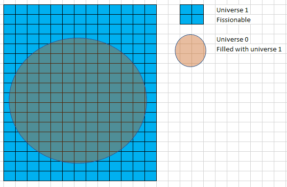

Hello
i am using MCNPX i have this warning message in output. Can you please tell me what dose this message mean and what is the reason of this warning message.
1299 fission cell elements had no neutron tracks entering:
1299 fission cell elements had no neutron collisions
1299 fission cell elements had no fission source points

It can mean one of two things.
First, it might mean you have too few particles in your run. If you have many cells with fissionable material, and you are doing a KCODE calculation, you need to be sure there are enough particles to produce at least a few fissions in every cell with fissionable material. Otherwise, you have a situation where the analysis is not testing the impact of those cells. You can check this by running a case with more particles in the KCODE. Probably the particles per cycle is the number to increase.
Second, it could mean you are using a universe to fill another universe. If part of the used-to-fill universe has cells with fissionable material, and those cells don't get used in the filled universe, you can get this kind of message. Like so. The blue squares are a region with fissionable material in universe 1. That's used to fill universe 0. The blue cells outside the circle have fissionable material in them, but never become part of the calculation. So the warning message.
You could check if this is the case by examining your model to find a possible place like that. Then, in your definition, change one of those universe 1 cells to a void and rerun. The number of cells warned about should go down. You got 1299. If you void a cell the number should drop.
If this last is the case, then you can ignore the warning message.
