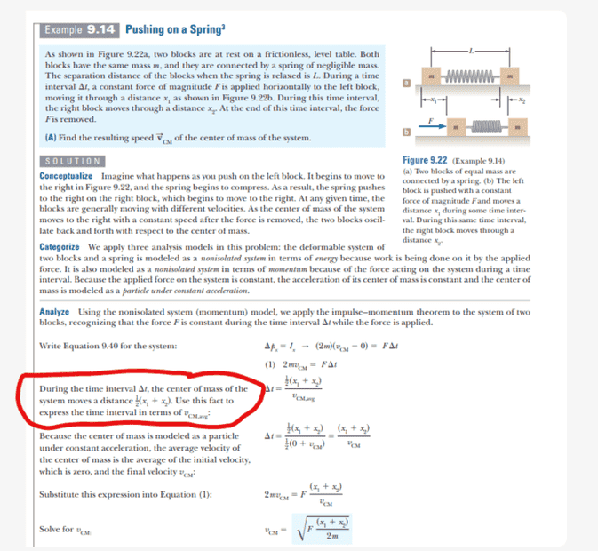

Why must you measure the COM of a system from the origin before and after a collision?
COM formula
For example, in the problem below, if the center of mass is chosen to be measured initially at the center of the left mass, then it must be measured from the same position after the collision.
This gives an initial COM of,
and finial COM of,
Which gives their change in center of mass of the system.
So why must I find the finial COM of the system with respect to the same place which I used to find the COM before the force was exerted on the system.
String theory guy said:
Homework Statement:: Why must you measure the COM of a system from the origin before and after a collision?
Relevant Equations:: COM formula
and finial COM of,
Because what we are trying to find is how far the CoM moved.
and finial COM of,
You can measure the center of mass from any position as long as you do it from the same place before any after the force. Hope that helps.
