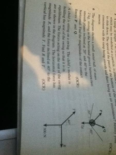

I'm struggling with question 6 and 7 on this exercise. I have no idea where to start so basic help would be needed to get me started.

In what direction would the normal reaction force by the planes act?
Can you resolve the weight vector to make sure that it balances the normal reaction vector?

For question 6, I need to go about finding the normal contact forces P and Q. How do I do that with the info I know?
Try finding the angles between the vectors, then resolve the "2g" vector using trigonometry in such a way that the vectors balance each other out.

well what is the angle of P relative to the horizontal? 40 degrees plus 90 degrees right?

resolve horizontally, to get an equation for P in terms of Q, let it be (1).
Now resolve vertically, to get another equation in terms of P and Q. Now substitute (1) in this equation to find Q.
So have now got Q, with this i can easily find P by substituting the value of Q in any of the equation.
And as i said before, i don't know if it is the right way, because i haven't came across such a question before.
