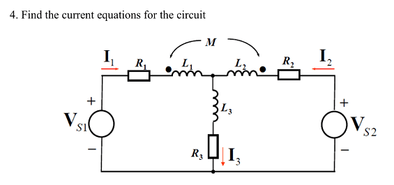

Are my equations correct?
[tex]I_3=I_1+I_2[/tex]
[tex]V_{S1}=I_1(R_1+jwL_1+jwL_3+R3)-I_2(jwL_3+R_3+M)[/tex]
[tex]-V_{S2}=I_2(R_3+jwL_3+jwL_2+R2)-I_1(jwL_3+R_3+M)[/tex]
Your loop equations look okay provided that your I2 is not the same as the I2 indicated on the diagram (they are assumed to be flowing in opposite directions).
Ah, my bad for not posting the complete question. For the first part, V2 is assumed 0, so they should be okay. Thanks!
