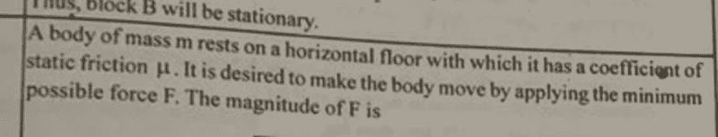

A body of mass m results on horizontal floor with which it has coefficient of static friction ##\mu##. It is desired to move the block with minimum possible force. Find the applied force F.
Seriously? You only now thought it relevant to tell us that the applied force F is at an angle?
No. This is the complete question. There is no mentioning of any angle as you can see.I don’t know why they are applying force at an angle.
So you are saying that the diagram you just posted has nothing to do with this problem?

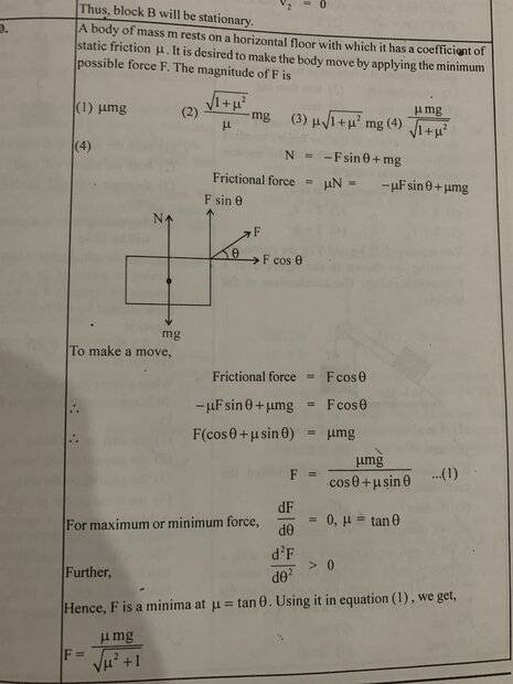

I am saying they have solved the problem assuming force at an angle. That diagram is not the part of question but of the answer.

Ah, I see the issue now. You were not told anything about the direction of the applied force, so you are free to apply it in any direction to solve for the minimum force needed. Assuming that the applied force must be horizontal was a mistake.
See my last post. Do you see how being allowed to apply the force at an angle can affect the answer?

Because that lowers the normal force and therefore the horizontal force required to move the block. Since the problem did not say anything about the direction, in order to find the minimal force, you need to find an expression for the required force as a function of the angle and then minimise with respect to the angle.

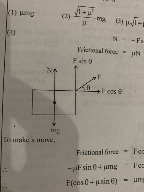

Is this more readable?
Likes Delta2

To apply minimum force the force of friction has to be less and will become less when we decrease the normal force and that would mean a tilted block.
But the eqns are ##F_N+F\sin \theta =mg##
##F\cos \theta=\mu F_N## which I don’t think is consistent with the tilted block.

No, it would not necessarily tilt the block. Why do you think so? There is a separate set of equations (based on torque balance) that would tell you whether the block tilts or not.
Why not? They are valid as long as the coefficient of friction remains the same.

But I get it. Force at an angle will have its component in the direction of normal and that will decrease the normal force and thus friction. It will be enough to move the block forward.
