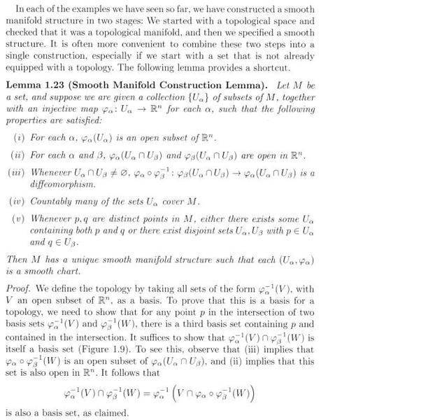

Looking at two of my (old) relativity texts, I came away with the following understanding:
The point set topology of the 4-manifold is established by building up overlapping one-one mappings to Euclidean R-4. This defines open sets and connectedness, but no geometry (for example, little overlapping pieces of Euclidian flat plane can be used to build a torus, sphere, or any other two-manifold, however connected). One imposes some type of invariance rules that different equivalent ways of doing this should have no effect on the topology (these were physics books, so they were vague on this). At this point, there is *no* metric or affine connection established; no distance, no parallel transport, etc. Then, how one imposes connections and distances builds the geometry; in this case, pseudo-euclidean for Minkowski, pseudo-Riemannian for GR.
PAllen said:
The point set topology of the 4-manifold is established by building up overlapping one-one mappings to Euclidean R-4. This defines open sets...
Each such map [itex]x:U\rightarrow \mathbb R^4[/itex] is required to be a homeomorphism onto x(U). This requirement doesn't make sense if the topology hasn't been defined in advance.
Do you know why this is true? It seems to me I can impose structure on an amorphous set of points by the mapping. That is, I declare each open set in the R4 patch to define a corresponding open set in the manifold under 'construction'.
I might be missing something subtle, but I don't see why you can't start with a set (that will become the manifold) without a topology, functions [itex]x:U\rightarrow \mathbb R^4[/itex] which have all the correct properties except those that require a topology, and then define your topology to be the inverse images of the open sets of [itex]\mathbb R^4[/itex].
EDIT: written at the same time as PAllen's reply!
With a bi of care, this can be done.
I think the problem with that is that there are an infinity of different choices of atlas (an atlas being a set of coordinate patches that covers the manifold together with the bijections from the patches to R4) and, without the constraint that the prior continuity requirement provides, different atlases will result in different topologies on the manifold. One atlas might make the manifold a torus and another might make it a sphere. In fact, even the dimension of the manifold will not be well-defined.
So if you don't start out with a topology on the manifold, you can't create a well-defined one via coordinate maps.
If you put some additional constraints on what type of coordinate maps you will allow, you can do it, but I think those constraints will define a topology. For instance you might say the only coordinate maps allowed are those whose domain is an open box in Minkowski space, but if you do so then you are imposing the box topology on the space (which Fredrik indicated above is a way to put a topology on the space without using a distance function).
The point is to define some topology. The dimension ambiguity I'm not sure I understand if all patches are to R4. The difference is between 'finding coordinate systems for some pre-established topology' versus choosing what you call an atlas to establish the topology. Of course, the nature of patches determines everything about the topology (see my connectedness example).
The key, for me, is something has to establish the topology before you can start defining geometry, but that something need not involve any distance function. This avoids having a topologic distance function separate from the metric distance function. This is the way some old relativity books I have seemed to define it: impose open sets and connectedness from the overlapping mappings to R4 patches; then start imposing geometry on top of the topology.
I have attached part of page 21 from Introduction to Smooth Manifolds by John M. Lee.
