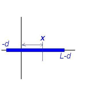

The density is M/L. Why did you use M/d and M/L -d as density? The second one is even dimensionally wrong.
You should integrate simply from -d to L-d.

The density of both pieces are the same M/L.
GreatEscapist said:
It's always just over the total length?
You are supposed to get the moment of inertia by direct integration of the square of the distance from the pivot from one end to the other one. You can replace one integral with the sum of other two, but why?
