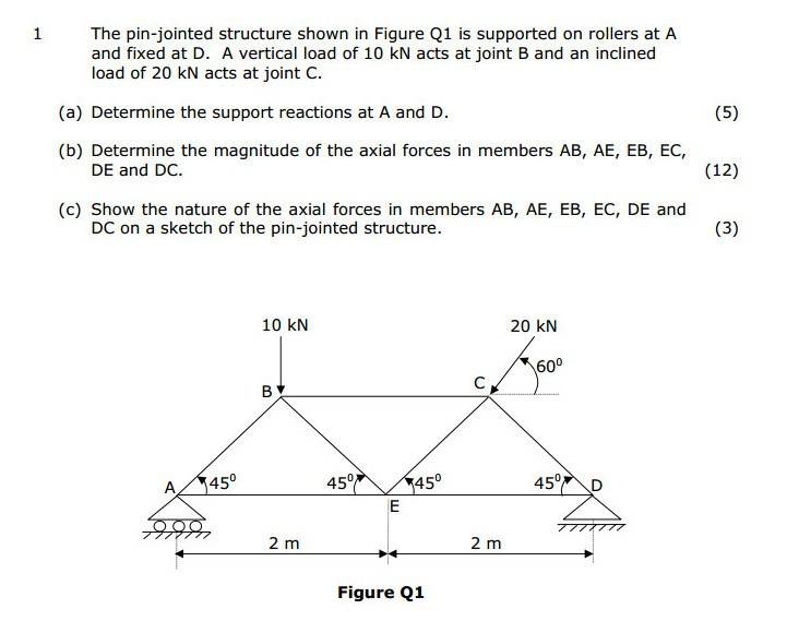

Hi,
I'm looking for help with this question, part (a).

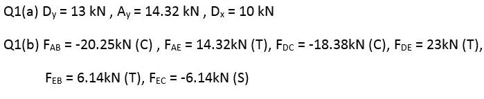

Should be noted that Cx = 10kN and Cy = 17.32kN.
Problem and solution below.
I've calculated Ay and Dx succesfully but I'm having problems getting Dy. Do I need to use moments again, and if so, how?
Thanks.
yes . take moment about A. consider moment contribution at C ...both X and Y.. u need vertical distance of load that act from base.. that would be 1 . so that's it
Likes smr101
OK, I've got it now, much appreciated.
