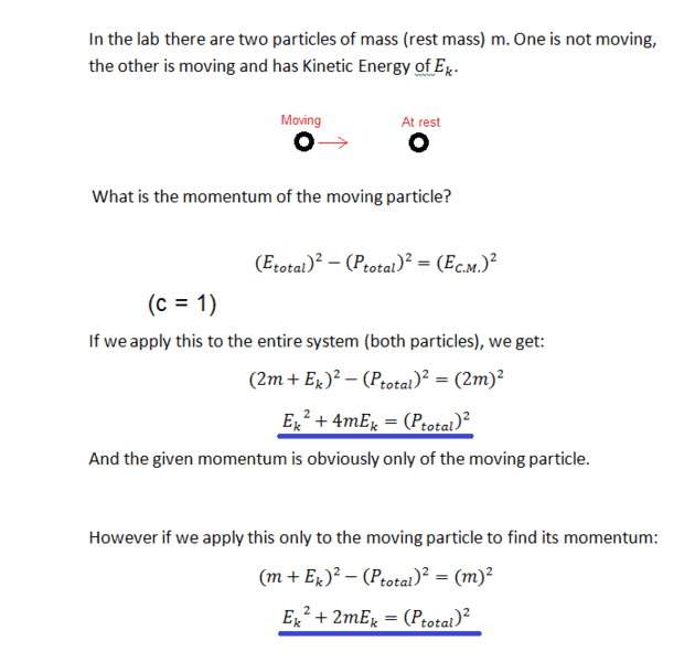

You use the energy-momentum relationship.what is the right way to find the momentum?
Momentum in special relativity is a measure of the motion of a particle or system of particles. It takes into account both the mass and velocity of the particles, and is a fundamental concept in understanding the behavior of objects at high speeds.
In classical mechanics, momentum is defined as the product of mass and velocity. However, in special relativity, momentum is defined as the product of the relativistic mass and the velocity, where the relativistic mass takes into account the effects of high speeds on an object's mass.
The equation for calculating momentum in special relativity is p = m * v / √(1 - v2/c2), where p is momentum, m is mass, v is velocity, and c is the speed of light.
