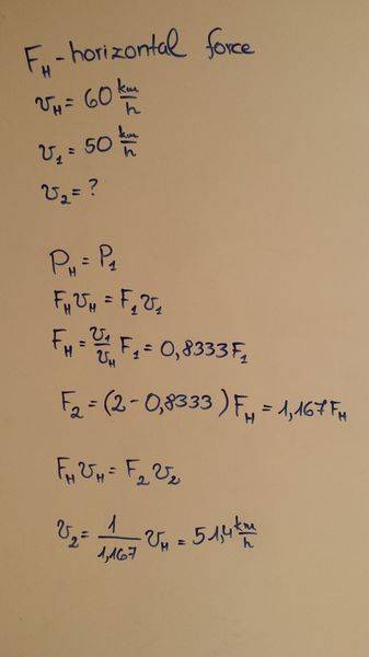

A car is moving on a horizontal road with speed of 60 km/h. When it starts to move on an inclined plane its velocity decreases by 10 km/h. How much its velocity will increase when the car starts to move down the plane? Assume that the power of the engine remain the same, any friction is neglectable.
Newton's Laws of Motion
The correct answer is 15 km\h. I don't understand this. Please help.

kaspis245,
I believe your mistake is in the equation attached below. How did you get this? Shouldn't F2 be less than FH? The engine will not need to provide as much force coming down the hill compared to traveling horizontally.

TSny said:
kaspis245,
Because of P1=P2 I got a ratio FH=0,8333F1. It means that horizontal force is 16,7% bigger than the force with which the car is moving upwards. Then I made the assumption that the force with which the car will move downwards should be bigger than the horizontal force by the same amount of percent. I see that my answer is somewhat unreasonable.
You say that F1 should be greater than FH but how about PH=PUP? It gives me a clear ratio FH=0,8333F1.

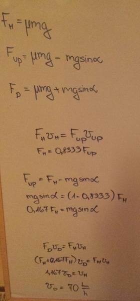

Hovever, I've found another solution:
It's still not the right answer but close.
But doesn't FH=0,8333F1 imply that FH is smaller than F1. So, F1 > FH.
First, I don't see a need to write FH as μmg. I would just leave it as FH.
For your expressions for FUP and FD, I believe you have some sign errors. FUP should be greater than FH in order to overcome the effect of gravity when going uphill.

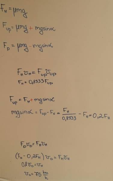

Does this mean the final answer should be 50+15= 65 km/h or 60 +15= 75 km/h?
I believe it should be 75 km/hr. This is another ambiguity in the wording of the problem statement. :confused:
I agree. (Only because I finally was able to get that answer.)
Everything turned out fine.
The answer is 15 km/h because the problem is asking how much it will increase, therefore Δv=75-60=15 km/h.
Well done, my friend. Treating FH as a simple friction force leads to a clear understanding of how the forces interact.
