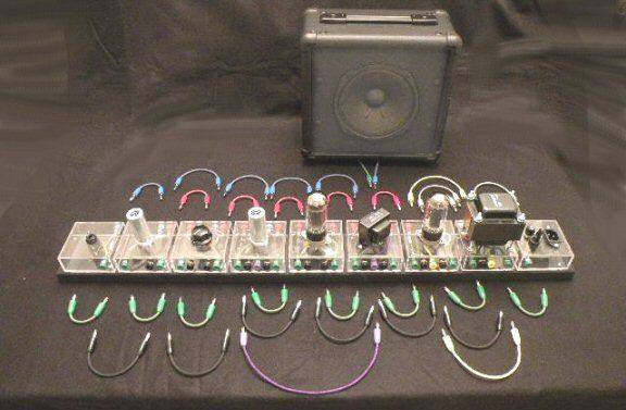

The ultimate goal is to explain the workings of a basic vacuum tube guitar amp circuit to a ten-year-old in electron-flow terms. Electron-flow terms because the workings of vacuum tubes are invariably described from an electron-flow perspective. (I realize this is an unusual approach to circuit analysis in these modern times, but it seems appropriate to me in this particular case.) Consider, for example, this excerpt from a book explaining how the varying flow of electrons coming out of a vacuum tube is converted to changes in voltage that are passed on to the next stage of the amp:
I think that's something the kid can easily picture: the varying voltage (at the point marked with the blue arrow) is the result of the varying excess/deficit of electrons at that spot (relative to ground). Which reminded me of descriptions of motional EMF from my college days (decades ago): hence this thread. After all, I thought, we're able to define current easily enough in terms of electron flow; perhaps we can similarly define voltage for the kid in terms of electron concentration (eg, excess electrons per proton, or per cubic centimeter, or something like that) and he can thus picture voltage (not as some abstract quantity with units of measure he's never heard of -- like "joules" and "coulombs" -- but) as the natural result of the mutual repulsion of electrons; as a measure of the electron's "unhappiness" or "dissatisfaction" at being unnaturally crammed together; a measure of their desire to redistribute themselves.
That sounds like a fair description. The electron flow model has some serious weaknesses, but as long as you understand that, it's a good intuitive model.

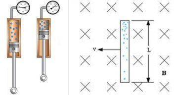

1. It seems to me that these two devices are conceptually similar:
The air molecules on the left are analogous to the electrons on the right, and the upward force of the piston is analogous to the upward force of the magnetic field. The air molecules like it less and less as they are pressed closer and closer together, and will immediately separate and distribute themselves more evenly given the opportunity; ditto for the electrons. It seems to me that we ought to be able to somehow relate electrons per cubic inch (or per proton, or something) to voltage (electrical pressure) in the same way that we intuitively relate "molecules per cubic inch" to air pressure.
2. Regarding capacitance: I'm sorry, but I don't see how capacitance applies in this case. The rod is conductive through and through -- it has no insulating dielectric that is being stretched or deformed due to the difference in electron concentration at the ends, and so it just doesn't look like a capacitor to me.
3. It seems odd to me that we can't get a relationship between voltage and a specific number of electrons even though we know that E=IR and that I is defined as 6.28x10^18 electrons per second past a given point. I don't understand the units of measure well enough, and my math isn't good enough, to get me further, but it seems like we ought to be able to relate the two based on that formula and that definition of current.
4. Thought experiment: Let's select L and v and B in the above drawing so LvB equals 1 volt. Then, while the rod is moving, let's connect a 1-ohm resistor across the ends of it. When we do (assuming we keep moving the rod at velocity v) we'll be pushing 1 amp's worth of electrons past any given point in the circuit every second: 6.28x10^18, to be specific. Now, without stopping the rod, we disconnect the resistor. The electrons will continue to "flow" upward until -- until what? Until, I would think, the force exerted by the mutual repulsion of the accumulated electrons at the top of the rod equals the upward force of the field. My guess is that this would be 1 amp's worth (or 6.28x10^18) since this is the number we were able to move, continuously, when we had a 1-ohm path all the way around. But of course that's just an intuitive guess from someone who is more of an artist than a mathematician. What would you guys estimate?
Even if we fully simulate the problem, the result cannot be a single number of electrons. You will get a large charge density at the top, gradually decreasing as you go down, crossing zero somewhere in the middle, increasing (but with opposite charge) again until you reach the bottom. That is not a number, that is a distribution - and, as mentioned, it is not easy to calculate it.

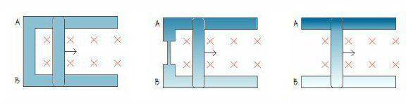

I understand that it's nearly impossible to track individual electrons (as my earlier drawings might have suggested). So let's use these drawings, where I've added conductive rails for the rod to ride on, and where the concentration of electrons is represented as a gradient, darker blue meaning more electrons in that area:
Now assume that L and v and B have been chosen so LvB is 1 volt, and that the rod is moving steadily to the right.
1. If the overall resistance of the left loop is 1 ohm, then by Ohm's Law (I=E/R) the flow of free electrons must be 1 amp's worth and the concentration of free electrons equal throughout the circuit (as indicated by the uniform blue color). Which means 6.28x10^18 electrons must be moving past any point in that circuit every second. Yes?
2. Now let's increase the resistance of the loop to say, 2 ohms, as depicted in the drawing in the center. Since LvB is still 1 volt, Ohm's Law now gives us 1/2 amp of flow or 3.14x10^18 electrons per second past any point in the circuit. But it seems to me there's still a potential (no pun intended) for greater flow since L and v and B haven't changed. In other words, there will be an excess of electrons at the top and a corresponding deficit of electrons at the bottom of the circuit in this case I've indicated this with the revised gradient -- darker than the center drawing at the top, and lighter at the bottom. Yes?
3. Finally, let's make the resistance of the loop ridiculously large by opening the circuit as in the drawing on the right. Current, in this case, will be negligible. But the potential (LvB) will still be 1 volt. Which means, according to the description of motional EMF at the very top of this thread, that the number of excess electrons at the top (and the corresponding deficit of electrons at the bottom) will be the maximum for this configuration and the selected L, v, and B variables. We thus get very dark blue at the top and a correspondingly very light blue at the bottom. Yes?
So (assuming all that is corrent) we know both the flow (6.28x10^18 electrons per second past any spot) and the relative concentration (equal everywhere) in the left case. And we know the flow (3.14x10^18 electrons per second past any spot) in the center case, and the flow (zero) in the right case. What we don't know is the relative (or absolute) concentration of electrons in the latter two cases.
It seems to me we ought to be able to calculate at least the relative concentrations in these latter cases by drawing a horizontal line through the middle of the circuit and averaging what's above and what's below.
And it seems to me that we ought to be able to calculate absolute concentrations once we figure out what to put in the denominator of those figures (ie, per proton, or per cubic centimeter, or something like that). After all, the energy is stored by pressing the electrons closer together than they want to be, which strikes me like compressing a spring (and where the stored potential energy is a simple 1/2kx^2).

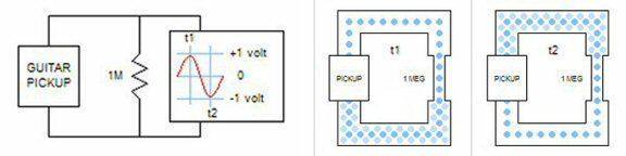

As you can see, I've attempted to illustrate the relatively high-voltage (2-volt) / low current (it's nanoamps) behavior of the circuit using the same kind of picture we get with motivational EMF above. Specificially, (a) uniform current throughout the circuit (the darker blue electrons), but (b) not uniform concentration of electrons (dark and light together). It is my understanding that it is this varying concentration of electrons that gives us the voltage swing, both here and in that junction between plate and plate resistor discussed earlier.
What bothers me is that I can tell the kid exactly how many electrons are flowing in that circuit at any point in time (since the current is known), but I can't tell him even what ratio of electrons it takes to account for those varying voltages. Seems like I ought to be able to do that without the need for higher mathematics.
The concentration won't be the same everywhere.
There is no fundamental difference between the 1 Ohm and 2 Ohm case here. In both cases the electron density will be non-uniform.
There is nothing special about "1 [Unit]" in general. We could have completely different unit systems, and physics would not change at all. We could have defined 1 Ampere as 1 electron per second, or 1 electron per year. Would you expect 1 electron separation (in some way) then?
Right. But we don't get the amount from that consideration. Also, "very large" is probably of the order of pico- to nanocoulombs for typical lab setups.

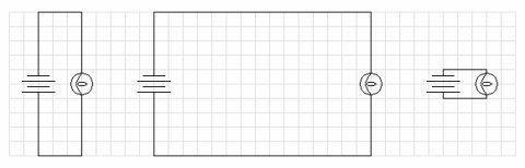

Unfortunately, I'm having trouble picturing point (3) above, circuit wise. Consider these three circuits (each with just a battery, a bulb, and some wire):
Let's say we've adjusted everything so the bulb will light with 1 volt, and the capacitance between that top wire and the bottom wire in the left circuit is about 0.88 pf, as above. That would mean we need an excess of about 5.5 million electrons on the top rail to make the thing work. So far, so good.
Now the center circuit is the same except the top and bottom rails are five times as long. Which means the capacitance is now five times greater and that means we need five times more electrons, 27.5 million, to make it work. Which is nevertheless understandable: we've got five times the "space" in those wires, so to get the same "pressure differential" we're going to need five times the number of excess/deficit electrons. Still good.
But now comes the problem. The right circuit is the same as the first except those top and bottom plates are now five times closer to each other, which again gives us five times the capacitance -- and thus the need for five times the number of electrons to make the circuit work. That makes no sense to me. I can see how this circuit makes a better capacitor than the other two; but I can't see why it should take five times the number of electrons to maintain a 1-volt differential between the top and bottom legs of the circuit.
Frankly, this anomaly makes me think the whole "capacitance approach" to the problem is not right. And not only for the reason just stated. It also seems odd to me that the current through that bulb might be as large as 6.2e+18 electrons per second, yet mere millions of electrons are involved in determining the voltage. Seems way out of proportion.

Then help me to make sense of it. Why should the circuit on the right require five times the number of excess/deficit electrons than the circuit on the left to maintain the same voltage differential across the bulb?

Jeff Rosenbury said:
Copper has a dielectric constant of about 6. (http://deltacnt.com/99-00032.htm [Broken])... I do question my source for the dielectric constant. It was for a catalyst which might be powder.
Yeah, I'm not buying that one. Looking around in books and on the web the consensus appears to be that the dielectric constant for conductors is infinity. Here, for example, is a clip from a book called, Comprehensive Physics:
And here's a similar argument from a paper on the web (bold highlight mine):
"In E&M, we learned the famous formula for dielectric materials: D(r) = ε E(r). D is the electrical displacement, which is related to the electric field caused by the free moving charge (the externally added charge). E is the electric field caused by the total charge, which includes the free moving and the bound charge (the internally induced charge). ε is the dielectric constant, also called permittivity, which relates the D to E. ε is infinite for metals in the limit where the applied field is spatially uniform. In this case, the electrons inside the metal are free to arrange themselves until their own electric field exactly counters the externally applied field D. Thus, the total field E becomes 0."
So how do we apply the "capacitance approach" in this case?
And I'm still wondering about my earlier question: Why should the circuit on the right require five times the number of excess/deficit electrons than the circuit on the left to maintain the same voltage differential across the bulb?
I have no idea how I would explain that to a kid. I understand that there is capacitance involved in all three configurations; I'm simply have trouble believing it's significant in any of the three cases. Makes it sound like what's going on between the wires is more important that what's going on inside the wires.
You are looking at the case of a perfect electric conductor (PEC) like a superconductor. In a PEC there is no electric field. The entire field is canceled by eddy currents since there is no resistance. Yet in normal metals there is some limited resistance. That resistance slows eddy currents and allows a field to form. So the logic of "No field, no ε" doesn't hold.

From above: "in the limit where the applied field is spatially uniform". Your applied field is not uniform. You have somewhat artificially set up a case where the underlying assumptions don't apply. Now you are using arguments based on those assumptions.
Capacitance is a defined quantity. It is defined as the charge divided by the voltage. You are arguing that this isn't the case. Well there's nothing wrong with that argument. As Lewis Carol wrote: "'When I use a word,' Humpty Dumpty said in a rather scornful tone, 'it means just what I choose it to mean -- neither more nor less.'" But don't expect others to agree with you or even understand you.
The answer to why a smaller circuit requires more electrons is because the electric field falls off with distance. Remember those electrons have paired protons somewhere. When the proton is near, it partially cancels the effects of the electron. When it's far, not so much.
You are correct that the capacitive approach may not be the best to solve this problem. I feel the lack of reliable ε measurements for metals make it problematic. Experimental data should be obtained. The test set up I envision would want a PEC to count the electrons across the small (differentialish) elements. Also, the value of ε might depend on the geometry (and temperature). (Remember ε is also a defined value. It relates the electric displacement with the electric field -- very similar to capacitance. There is no requirement that the number be a simple real value.)

Okay, let's try this one:
I charge up a capacitor (value discussed below) to 1 volt and then insert it as shown in the circuit above. The resistor is 1 ohm, so the current is initially 1 amp. A larger capacitor will maintain the flow longer, but will not increase the voltage. The voltmeter shows the voltage starting at 1 volt and dropping from there. It seems to me:
1. That the voltage between A and B is related to the ratio of excess/deficit electrons on the top/bottom of this circuit. Yes?
2. That the number of excess/deficit electrons may be substantial. For example, if the capacitor is large enough to sustain a 1-amp flow for 1 second, then the number of excess electrons must have been at least 6.2e18 at the start. Yes?
3. That a larger capacitor can maintain the 1-volt reading longer, not because the ratio of excess/deficit electrons is different, but simply because it takes longer to move enough electrons to significantly change that ratio. Yes?
So far so good? I hope so. Now for the $64,000 question:
4. What's the relationship between the various ratios of excess/deficit electrons that exist in this circuit at various points in time, and the voltage readings we see on the meter?
