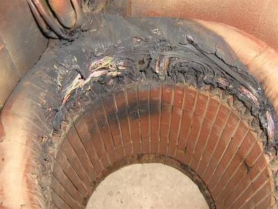

I used to think this question would be a simple question, but I haven't been able to get a good explanation from anyone (including two electrical engineers). So, here goes
During a brownout (periods where a building does not receive it's normal level of voltage) motors can potentially overheat to the point of failure. As I have been lead to understand, it is because motors are designed to operate at a certain HP (745 watts). So, when the voltage drops, the current will have to increase in order to maintain this HP. However, the windings of the motor may not be able to handle this current, and the excessive heat can pose a real danger to the integrity of the motor. The part I can't understand is - what component on the motor is drawing this extra current. It's my understanding that a motor is a dumb piece of equipment that operates at a given HP when it's on. I just don't understand what part of the motor is drawing this additional current, and how it knows to draw this additional current.

I totally understand that the windings are what will overheat, and I understand they will overheat because they are drawing extra current due to the drop in voltage. What I don't understand is how they draw this additional current. Motors don't typically have sensors that can detect a loss of voltage and then tell it to draw more current so it can continue to function at its rated HP. Without these sensors I just don't get how a motor can "know" that it's not getting full voltage and "knows" that it needs to draw more current (even though doing so will damage it). That is where I'm getting hung up.
On most AC motors the rotational "synchronous" speed is locked (The EMF and back EMF close to balance "small slip") to the power frequency. To maintain that speed with a load requires a level of power that is obtained by drawing current from the supply voltage on the motor windings. As the needed current increases with voltage drops the wires resistance causes heat and restricts the needed power to the point the rotational speed (and the motor cooling fan) slips below the lock frequency causing large reactive currents (back EMF unbalanced "much larger slip")in the internal wiring that saturate the cores creating harmonic currents with even more heating until the whole thing smokes.
you ought to familiarize yourself with "Speed-Torque Curve" for induction motors.
See Microchip's induction motor tutorial, it's their AN887.
When you do that you'll understand the basic point which is this:
Power an induction motor can deliver is in proportion to the square of applied voltage.
An induction motor can withstand a brief overload to perhaps 175-200% of its rated power.So a 1hp motor at 70% voltage becomes a 1/2 hp motor.
If it is connected to a load that requires more than 1/2 hp, it will be overloaded and burn up.
If it is connected instead to a load that requires less than 1/2 hp it will continue to run just fine.

It does't draw more current because the voltage was low, to compensate. as you said a motor is a dumb piece of equipment that only draws current based on applied voltage and resistance.
BUT the thing is, as the voltage is decreased, it draws less current as well, but since the motor is now spinning a lot slower, there is less Counter-emf developed that bucks the source voltage, and the "limited" amount of current draw is still more now than it was at higher voltage. you see what I mean?
Motors draw ONE value of current ALWAYS (for a fixed temperature). The time when a motor draws max current, is when it is not rotating. As it starts to rotate, it develops counter emf, which inhibits the draw of current. That is why during your brownout, there was a low voltage applied, which meant low current was drawn initially, but with this applied power the motor could not turn much, there was little counter emf developed and therefore the motor draws more current than if it ran.
I really wish I could rid of that saying, tha motors "compensate" by drawing more/less current opposite the voltage, it si simply not so. Only motor's with drives are smart enough for that. As for the rest, its counter EMF.
The same is true for ALL motors ac or dc, and for all applications. That is why motors burn our on undervoltage, and why they burn out when stalled. if they are not moving, they are not developing counter emf, and they are not limiting current draw. which means current is drawn in excess to what the windings can handle.

So yes, the answer is during a brownout, the voltage applied is low, therefore the motor does not speed up enough to develop counter emf, and can burn out due to excess current draw. (the current that burns out the motor, is still less than normal start-up current, it just cannot handle excess current for EXTENDED PERIODS OF TIME, that is another thing to remember, its not the current value, its the time the current is experienced by the motor, because really the current value in amps which destroyed the windings is still less than normal locked rotor (start up) current in amps)
