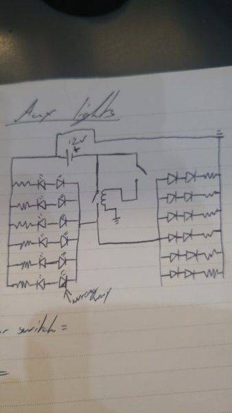

Hello all i want to put some led lights onto my motorbike and i just wanted to know that this circuit is correct and yes I've drawn some leds the wrong way round. I want.to use a relay so that the current( even tho should be less than 1amp ) doesn't go though the switch although shoulnt really need it i think
Cheers
Tia

Yes, that general circuit should work OK.
Relays can be tricky. Read the data sheet and app notes carefully.

In the wiring diagram, the group of diodes on the left will not light. They are wired "back to back", i.e. in each series pair one diode will be back biased regardless of applied polarity. The diode group on the right of the diagram looks fine.
evilfreddie said:
... and i just wanted to know that this circuit is correct and yes I've drawn some leds the wrong way round.
It is noted on the circuit diagram.
