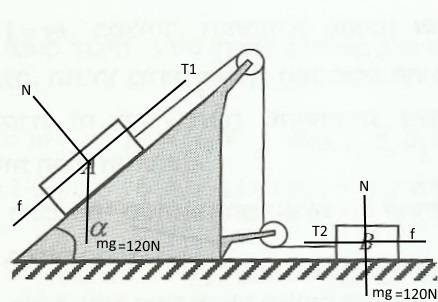

Log A weighs 20Kg is laid on a diagonal smooth plane with a diagonal angle of 27 37 degree, log A is tied by a rope to the head of the plane and there through a wheel with no friction the rope descend vertically to the bottom of the plane and through another friction-less wheel is tied to log B that weighs 20 Kg and is laid on a smooth horizontal plane' the last part of the rope tied to log B is horizontal
1. what is the time in which log A will move a 1 meter distance on the plane if it starts from rest?
2. what is the tension in the rope attached to both logs?
is acceleration here 0? or maybe 6? I'm a bit lost would appreciate any help, thx!

Well, you know the acceleration can't be zero, else the first question would not make sense.
Do this: Analyze the forces acting on A and on B. Apply Newton's 2nd law to each.

Is this correct? btw angle is 37 and not 27
Well, you don't show arrows. (Forces have direction.) And what does "f" represent? How do t1 and t2 relate?
f - friction ohh, but they said smooth surface, so no friction
and T1 = T2?
Right.
JAZZ541 said:
and T1 = T2?
Right. The tension is the same throughout the rope.

I have this:
1.
m1(A)g = m2(B)g = 20Kg
X = 1m
mag • sinα – T = m1a
T = m2a
mag • sinα -T + T = m1a + m2b
200 • 0.60 = a(m1 + m2)
a = 120/40 = 3m/s
X = V0T + at^2 /2
1 = 0 + 3t^2/2
2 = 3t^2
t = 0.816s
2.
T = m2a
T = 20 • 3 = 60N

Good!
(1) Your first equation should be: ##m_1 = m_2 = 20## Kg
(2) Careful with units. Acceleration has units of m/s^2.
(3) It's almost always better to stick to symbols as long as possible before plugging in numbers. Here's how I'd do it:
Since the masses are the same, I'd use "m" for both masses. And since the acceleration is the same, I'd use "a" for that.
##mg\sin\theta - T = ma##
##T = ma##
Adding them, we get:
##mg\sin\theta = 2ma##
And so on.
Note that the mass cancels out! So it doesn't matter (at least for this part of the question).

JAZZ541 said:
3.
If there is a friction between log B and the horizontal surface what is the minimal static coefficient of friction in which if the system is in a state of rest then it will remain in that state?
(1) What additional force acts on B? (Use symbols, not numbers.)
(2) What is the acceleration?
Redo your force equations with this in mind.

a = 0 ?
mgsinα = T = f = mumg ?

Then:
mu = sin37° = 0.6
