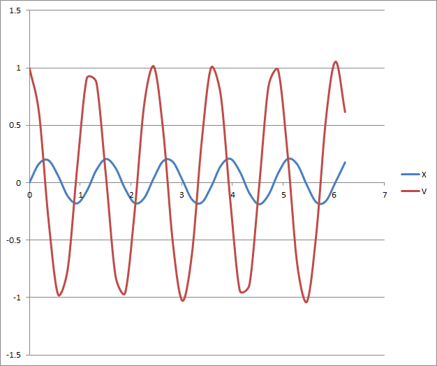

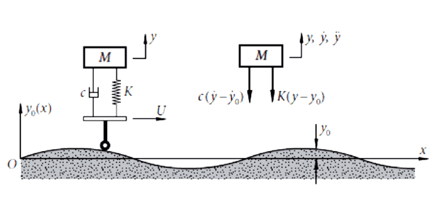

Hi there I am really new into programiing thing, and I am trying to make program of this problem usin FORTRAN
YR_8BJaNxuJYPJQQJYw6KIjl3xbpfDhg0Bvtq6GtmextbOnGwi9JRCOZihoHMBFDq0q3l_2kEaTXWAnddevvodp2i8VbC9Yw.png
I want the output to be Time,poisiton,velocity and contact force
and i already know
= amplitude
U = velocity of the car
d = rail distance
and so far this is my program <Moderator's note: please use code tags>

grecko94 said:
But i still have no idea how do i make contact force loop
What makes you say that ? You have the equation of motion in there, isn't it ?
First thing I notice is the different arguments for the sine and the cosine -- one of the two is wrong.
So what was it you expected to get ?

since F = -K(Y-Yo) -C(y°-yo°)
then a = -k/m(Y-yo)-C(y°-yo°)
isn't the code supposed to be
Code:
-k/m*(x(i)-am*sin(wb*u*dt))-c/m*(v(i)-wb*U*am*cos(wb*dt))
and maybe i should make the initial condition velocity of spring to zero
for the contact force I'm thinking about something like this
F = -k*(x(i)-am*sin(wb*u*dt))-c*(v(i)-wb*U*am*cos(wb*dt))
but i know something is off with this code

because
Y is the displacement of the spring which in my program is x
Yo is the wavy surface profile
and since Yo = A sin(Ωt)
then the code
Code:
am*sin(wb*dt)
and yo° = ΩA cos(Ωt)
and the code
Code:
wb*am*cos(wb*dt))
Ω= wb
U= car velocity
dt = time
Why do you multiply wd dt with u ?
you are right, i don't need u
