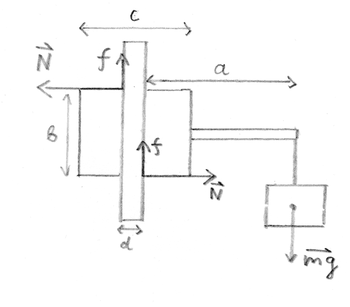

There is a rod with a nut on it. Diameter of rod is d. There is a mass m object as shown in picture. all other parameters (a, b, c) are known. What coefficient of friction should be, so that nut is not moving.
Sum of moments and Newton I law.
I tried to draw a free-body diagram and sum of moments equal to zero, but I stuck there, because I don't know where should reaction force N be and how determine where friction is acting on round surface? Any ideas?

I imagined that free-body diagram should look like this:
So then we have
$$2f=mg$$
And if we choose left side upper point of a rod as rotation point
$$mg(a+d)=fd$$
Actually, I'm not quite sure how torque equations should look for this system.
And I cannot solve anything from the equations above.
The diagram looks pretty good. Excellent, even. I had a different rotation axis in mind, but any choice will work.
[The axis I had in mind was in the middle of the nut, halfway between the two contact patches. The idea would be that this choice would let the ##f## drop out of the torque equation, hopefully simplifying things slightly. This would also make it obvious that you've missed accounting for the main torque].
You've properly identified the points of application of the relevant forces.
I agree with ##2f=mg## for the balance of linear forces.
I do not agree with ##mg(a+d) = fd## for the balance of torques. You have missed at least one torque.
You have not yet used the coefficient of friction or the assumption that both points of contact are on the verge of slipping.
You've assumed that both normal forces are identical and that both frictional forces are identical without making an argument that such must be the case. Not a big problem -- there is a simple argument that both must indeed be the case.
Well, if we suppose object is not moving, there are only to forces in y axis. So they must be equal. We supposing that coefficient of friction is equal everywhere, so that makes both friction forces equal.
If I make axis through a rod center. Equation becomes:
$$mg(a+\frac{d}{2})-N\frac{b}{2}-N\frac{b}{2}+f\frac{d}{2}-f\frac{d}{2}=0$$
$$mg(a+\frac{d}{2})-N\frac{d}{2}-N\frac{d}{2}+f\frac{d}{2}-f\frac{d}{2}=0$$
I get final expression of friction coefficient as:
$$\mu =\frac{4d}{2a+d}$$
Which is strange as it doesn't depend on mass.
Is the first equation right?
I was all set to agree with your torque balance equation but it has a problem. What is the moment arm for the ##N##? It is not ##\frac{d}{2}##.
As for the coefficient of friction not depending on mass, that makes perfect sense. If you double the mass, you double all the forces. But coefficient of friction is not about forces. It is about force ratio. If you double all of the forces, their ratios all remain unchanged.
Yes, my bad. It should be ##\frac{b}{2}##.
