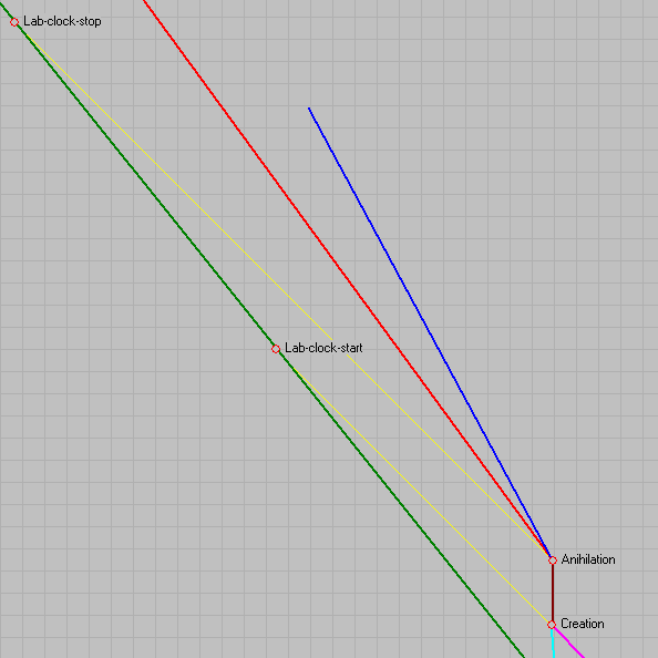

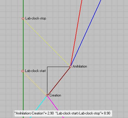

The shortening/lengthening is not relevant. The scenario can be set up as a spacetime diagram. I attach one showing the events in the lab frame and the muon frame. The clock times are the same in both, naturally.
