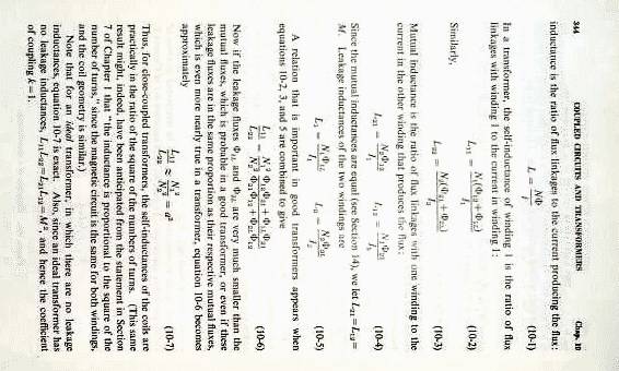

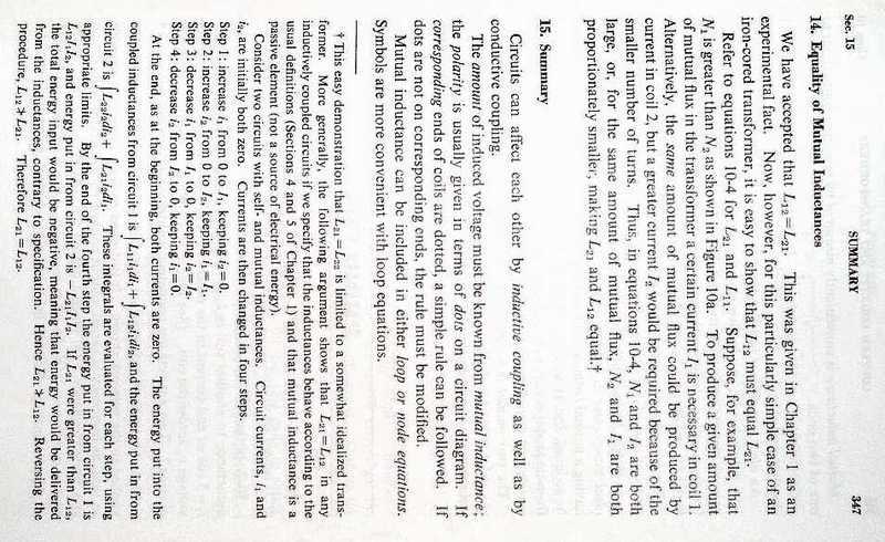

It may be helpful to see the question addressed from a circuit theory point of view.
Here are a couple of pages from a circuit theory text by Skilling, showing a proof of the equality of the mutual inductances of a pair of coupled coils. At the top of Page2 is a description of the case of a somewhat idealized transformer. Some equations from a previous page (Page1) are referenced.
The footnote at the bottom of Page2 is for a general case.
753
Thankyou very much, The Electrician, for responding.
So, what I gather from the pages is,for an ideal transformer,the self inductances are in the square of the ratio of the number of turns,whereas the mutual inductances L12 and L21 are equal.
However,the only proof to the latter seems to be given by considering that the total flux produced by either coil has to be equal to that produced by the other....based on this,from the expression of mutual inductance,we reason out,quite easily,that L12 =L21 .
The only thing is,during operation of a transformer,current is supplied to only one coil at a time...and that one operating coil produces some amount of flux,according to the number of turns and current supplied.....but is it really necessary that when the power is now supplied to the other,it should produce the same flux?
Also,it states that the mutual inductances of the coils should be equal,even if the transformer isn't ideal...how can that be? After all,in case of a non ideal transformer,each of the coils has its own coupling factor k1 and k2,which are of different values (depending on the geomtery and shape of the coils)...so now,the flux produced by one and linked to the other are not the same..
