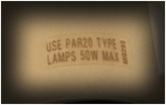

If you look inside the fixture housing, is there a little sticker that gives the maximum wattage bulb that is allowed (even before cutting down the airflow with a transparent covering)?

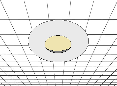

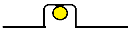

I will draw a 3d picture.
I looked at the bulbs again I think some are incandescent but I have a mix of bulbs. One solution I am thinking of is just get larger bulbs that completely enclose the area, however, based on your post, this could result in the bulb running too hot. But since I don't use the bulbs that often maybe that is not that much of an issue.

berkeman said:
If you look inside the fixture housing, is there a little sticker that gives the maximum wattage bulb that is allowed?
paradisePhysicist said:
Not sure.
It will look something like this, stuck inside the fixture where you can see it when replacing the bulb:
Likes Bystander
