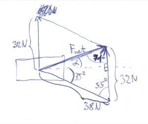

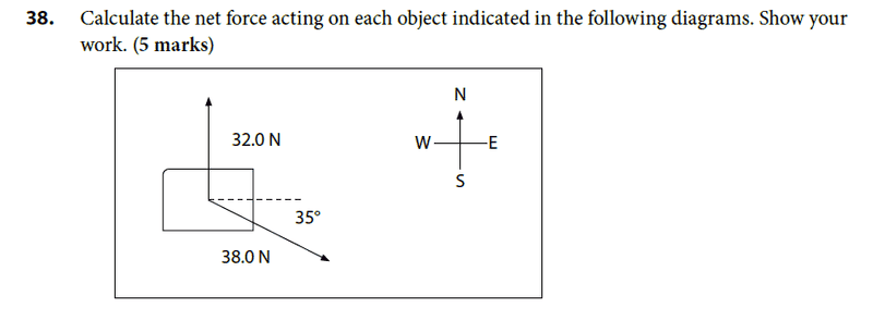

38)
c^2=a^2=b^2-2abcosC
c=([32.0N]^2=[38.0N]^2-2[32N]*[38N]cos125)1/2
c=62.15N
sin law
32/sinA=62.2N/sin125
=24.8 or 25
i have no idea how to do the other two questions. please help ASAP!

Unless I misunderstand the problem statement, the net force here will be the algebraic sum of the two force vectors. Applying the law of cosines as you did gives you the difference of the two force vectors.
Also, you must supply a direction along with the magnitude of the force in order to have a complete answer.
As SteamKing mentioned, you've calculated the magnitude of the difference of the two vectors, not the magnitude of the net force, which you would get by a vector sum.
The point of all these problems is to resolve the forces into two perpendicular components, an x-component and y-component, by using trigonometry, in order to simplify the addition of vectors. After you've resolved all the forces into their components, you just add all the x-components together to get a net force ##F_x## in the x-direction and add all the y-components to get a net force ##F_y## in the y-direction. The total net force ##F_{net}## will be the vector sum of ##F_x## and ##F_y##, and since these two are perpendicular to each other, you just need to use the Pythagorean theorem to determine that the magnitude of ##F_{net}## will be ##\sqrt{F_x^2+F_y^2}##. To determine the direction of the net force, you need to find the angle in the triangle with sides ##F_x##, ##F_y## and ##F_{net}##, which can be determined using ##\tan{\alpha}=\frac{F_y}{F_x}##, and thus ##\alpha=\arctan{\frac{F_y}{F_x}}##.
You can find some examples at http://www.physicsclassroom.com/Class/vectors/u3l3b.cfm and http://www.physicsclassroom.com/class/vectors/Lesson-3/Net-Force-Problems-Revisited.

The way that it is shown to me is using sinA/A=sinB/B=sinC/C or tan=opp/adj
so what i did was 62.2N/sin125=32.0N/sin
=24.8 or 25 deg

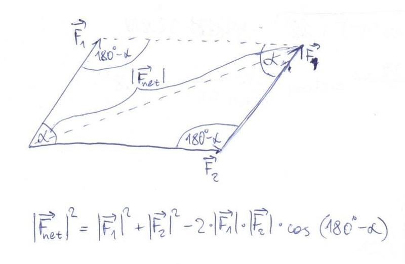

I'm assuming you haven't learned about force components, so a different solution to this problem might be to complete a parallelogram with sides equal to the two force vectors and use a Cosine Rule in that parallelogram (see the attached image). When you have completed such a parallelogram, you can use the Cosine Rule in the triangle with sides ##F_1##, ##F_2## and ##F_{net}##, as shown in the image, from which you can determine ##F_{net}## using $$F_{net}^2=F_1^2+F_2^2-2\cdot F_1 \cdot F_2 \cdot \cos{(180 -\alpha)}$$ Once you've done that, then you can also find the angle of ##F_{net}## using the Sine Rule in the same triangle.
So, try completing a parallelogram in your problem and see if you can apply the Cosine Rule to that parallelogram.

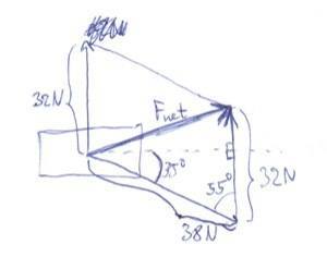

this is what i get by using the method you suggested to me:
180deg-35deg=145deg
Fnet^2= F1^2+F^2 -2(F1)(F2) cosC
Fnet^2=32N^2+38^2 -2(32N)(38N)cos145
Fnet^2= 4460.17
square root of 4460.17 = 66.78 or 67N
sin 145/67N=sin/38
sin=38N sin145/67N
sin=21.79/67N
sin-1(0.3253)
=18.9 or 19deg
Fnet=67N [N 19deg W]
is this right?

This is still incorrect because the case I described holds for a general case where ##\alpha < 90##, which isn't the case in your problem #38, but holds for example for the last problem you attached. For the case where ##\alpha > 90##, which is the case in problem #38, you would need to draw a slightly different parallelogram, but the principle is the same: you want the diagonal to be ##F_{net}## and the two sides to be the two given vectors ##F_1## and ##F_2##, from which you can determine ##F_{net}## using the Cosine Rule in that triangle. To help you a bit more, see the following drawing for problem #38, where I've calculated the angle between ##F_1=38N## and ##F_2=32N## to be 180-90-35=55 degrees. Now you should be able to calculate ##F_{net}## using Cosine Rule and its angle using the Sine Rule.
helium4 said:
This is still incorrect because the case I described holds for a general case where ##\alpha < 90##, which isn't the case in your problem #38, but holds for example for the last problem you attached. For the case where ##\alpha > 90##, which is the case in problem #38, you would need to draw a slightly different parallelogram, but the principle is the same: you want one side to be ##F_{net}## and the other two sides to be the two given vectors ##F_1## and ##F_2##, from which you can determine ##F_{net}## using the Cosine Rule in that triangle. To help you a bit more, see the following drawing for problem #38, where I've calculated the angle between ##F_1=38N## and ##F_2=32N## to be 180-90-35=55 degrees. Now you should be able to calculate ##F_{net}## using Cosine Rule and its angle using the Sine Rule.
I knew that the angle part couldn't be right!
so this would be my answer now that i have changed the angle to 55deg:
90deg-35=55deg
Fnet^2=32N^2+38^2 -2(32N)(38N)cos55
Fnet^2= 1073
square root of 1073 = 32.7N or 33Nsin 55/33N=sin/38
sin=38N sin55/33N
sin=31.12/33
sin-1(0.9432)
=70.6deg or 71 deg
Fnet= 33N [N 71deg W]

Great, you're almost there. The magnitude of the net force is correct, but you calculated a different angle. If you look at the drawing, you'll see that the angle you calculated is actually the angle between the vectors ##F_{net}=33N## and ##F_2=32N##, but what you want is the angle between the vector ##F_{net}## and the horizontal. So, what would be the correct angle?
angles are my weakness! would i do sin55/33=sin/32 ?
You need an argument for the sin/32 bit. IOW, which angle are you talking about?
Well, you have more options. First, you can use the angle 71° between ##F_{net}=33N## and ##F_2=32N## that you've already calculated and use the fact that the angle ##\alpha## (angle between ##F_{net}## and the horizontal), the 71° angle and a 90° angle are in the same triangle, and so you can determine ##\alpha## from that triangle.
Another option is to find the angle ##\beta## between ##F_{net}## and ##F_1=38N##, which is what you tried to do now with the Sine Rule ##\frac{sin{55}}{33}=\frac{\sin{\beta}}{32}##. For this angle, you know that ##\beta=\alpha+35°## (see the drawing), and so you can also determine ##\alpha## from there.
Also, as SteamKing pointed out, it would be nice to write the sine of angle ##\theta## as ##\sin{\theta}## instead of just ##\sin##, since we don't know what angle you're talking about.
So, what's the final angle ##\alpha##, then?

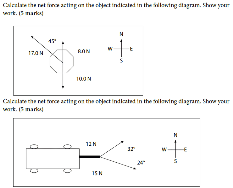

i've tried the second answer:
10N=8.0N[N]
10N-8.0=2N
Fnet^2=2n^2+17n^2-2*2n*17Ncos45
Fnet^2=244.9
square root of 244.9=15.6N or 16N
sin/17N=sin45/15.6
=12/15.6
sin-1(o.77)
=50deg
50deg-90deg=40deg
16N [W 40deg S]

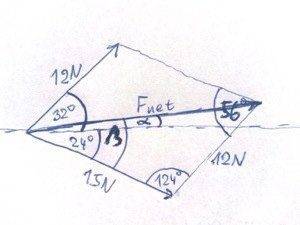

my third answer is :
180deg-56deg=124
Fnet^2=15^2=12N^2-2(15N)(12N)cos124
=24N
sin/12=sin56/24
=sin-1(0.4145)
=24.5
24N [W 24deg S]
I think we were talking about different angles. The angle between the two force vectors (55°) you calculated earlier was correct and the magnitude of the net force (33N) was correct:
MaryBarnes said:
90deg-35=55deg
Fnet^2= 1073
But the direction of the net force (i.e. the angle ##\alpha## between ##F_{net}## and the horizontal) was incorrect, because if you look at the attached image, the 71° angle you calculated is between the net force vector and the 32N force vector, not between ##F_{net}## and the horizontal:

What you want is the angle ##\alpha##, since that gives you the direction of ##F_{net}##. Now it should be pretty easy to calculate ##\alpha## from the image.
helium4 said:
I think we were talking about different angles. The angle between the two force vectors (55°) you calculated earlier was correct and the magnitude of the net force (33N) was correct:But the direction of the net force (i.e. the angle ##\alpha## between ##F_{net}## and the horizontal) was incorrect, because if you look at the attached image, the 71° angle you calculated is between the net force vector and the 32N force vector, not between ##F_{net}## and the horizontal:What you want is the angle ##\alpha##, since that gives you the direction of ##F_{net}##. Now it should be pretty easy to calculate ##\alpha## from the image.
is it sin 55/33=sin/32
sin-1(o.7943)
=52.59 or 53deg
you said that the B= A+35deg
so that would mean that A =B-35 deg?
53-35=18 deg

Yes, the angle 18° is correct, so the correct answer for the first problem is ##F_{net}=33N## with ##\alpha=18##°. You could also have calculated ##\alpha## from the triangle where one of the angles is 71°, by doing which you would also get approximately 18°.
In your third answer, the magnitude of the net force ##F_{net}=24N## is correct, but the angle is incorrect because you have used the Sine Rule in some triangle that doesn't exist. I suggest you to draw a sketch for each problem with a completed parallelogram and angles properly annotated so that you can see in which triangles you can apply the Sine or Cosine Rule. Otherwise, just blindly applying a formula for the net force and angle doesn't have any purpose. To get you started, I have drawn a sketch for the third problem (where you already calculated ##F_{net}## to be 24N) with annotated angles, where you can use the Sine Rule to determine angle ##\beta## and once you know that, you can also find ##\alpha##.
The principle in the second problem is the same as in the others, but you'll need to use more parallelograms. Note that all of this would be much easier if you could just resolve all the forces into their x and y components and use the method I outlined at the beginning of this thread. Try doing some examples from the links I've posted there, it's really very easy to do.
"In your third answer, the magnitude of the net force ##F_{net}=24N## is correct, but the angle is incorrect because you have used the Sine Rule in some triangle that doesn't exist. I suggest you to draw a sketch for each problem with a completed parallelogram and angles properly annotated so that you can see in which triangles you can apply the Sine or Cosine Rule. Otherwise, just blindly applying a formula for the net force and angle doesn't have any purpose. To get you started, I have drawn a sketch for the third problem (where you already calculated ##F_{net}## to be 24N) with annotated angles, where you can use the Sine Rule to determine angle ##\beta## and once you know that, you can also find ##\alpha##.
View attachment 84182"
"The principle in the second problem is the same as in the others, but you'll need to use more parallelograms. Note that all of this would be much easier if you could just resolve all the forces into their x and y components and use the method I outlined at the beginning of this thread. Try doing some examples from the links I've posted there, it's really very easy to do."
I'm sure the answers seem simple to you, but I am having great difficulty understanding how to draw diagrams with angles, and figuring out which angle is which. Thank you for being patient with me and helping me out!
I have tried the answer once again. I think it should be:
sin124/24N=sin/15N
=31deg
31 deg-24deg =7deg
i hope this is the correct answer :nb)

Well, this is once again incorrect because you used the Sine Rule to calculate the angle between the vectors ##F_{net}=24N## and ##12N##, which is the angle opposite to angle ##\beta## (look at the sketch). Just remember, when using the Sine Rule, you always use a pair of angle and a side opposite to that angle. Therefore, since you used the equation $$\frac{sin{124}}{24}=\frac{sin{\theta}}{15}$$ the angle 124° must be opposite to side with "length" 24N (which it is), and the angle ##\theta## which you are solving for must be opposite to side with "length" 15N. However, the angle opposite to side with "length" 15N is not ##\beta##, as you can see from the sketch. Therefore, since you want to solve for the angle ##\beta##, you would need to use the Sine Rule with side of "length" 12N instead of 15N, since the angle ##\beta## is opposite to the 12N side. So, try changing your equation for the Sine Rule to reflect that.
so now I've tried tried what you suggested and I got 24.48 deg. Is this right?
Yes, that's roughly the correct value for ##\beta##. Now you can use that to calculate ##\alpha## as you did before.

if i subtract 24deg from 24 deg i get 0? is this really the answer?

Yes, the angle of ##F_{net}## is roughly 0° (more precisely, it's something like 0.6°, so it's not quite horizontal).
As for the problem with the three forces, you could approach it the same way as these two problems, but you would first need to combine two of the forces into a parallelogram and than take this force and the third force and combine those two into a parallelogram, which would give you the net force. However, the method with breaking the forces down into their components is in my opinion much easier than the parallelogram method, especially if there are more forces involved. Besides, it's a good skill to have for solving more complex problems.
So, good luck with that and let me know if you need any more help.

I tried the third answer using the sin and cosine law. Is this right?
fnet^2=2N^2+17N^2 -2(2N)(17N)cos45
Fnet=square root of:244.9
Fnet=15.6N or 16N
sin45/15.6N=sin/2N
sin=2Nsin45/15.6N
sin-1(0.0906)
=5.2deg
Fnet=15.6N or 16N
sin45/15.6N=sin/2N
sin=2Nsin45/15.6N
sin-1(0.0906)
=5.2deg
45deg-5.2deg=40
Yes, that's correct, but you need to say that ##F_{net}## points to the left with 40° angle between the vector and the horizontal (i.e. points in the NW direction), otherwise it may seem as though it would point to the right (NE direction), which would be incorrect.
  • #31
Ok, thanks for mentioning that. Thank you for all of your help! Now I actually understand how work with these equations!
