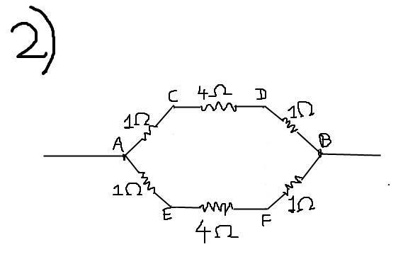

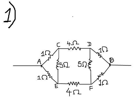

Find the Net Resistance between A and B in attachment 1.
The circuit in attachment 1 simplifies to attachment 2 from the fact that the points C and E are equipotential. Same goes for D and F. So we remove CE and F as no current passes through equipotential points. But why? How are these 2 pairs of points equipotential?

Would you agree there must be a unique solution to the potentials and currents?
Because of the symmetry in the diagram, all equations which you obtain must be similarly symmetric: swapping the potentials and flows around a horizontal axis must also be a solution. As the solution is unique, potential at C = that at E, etc.
You might think of the problem this way. Start with diagram 2. Put a battery or any voltage between A and B and call B Ground. Then calculate the voltage at points C and E with respect to Ground. You will find they are the same. So no matter what resistance you place between C and E, no current will flow because there is no voltage difference between C and E. This is why you can remove the 5 ohm resistors. If the circuit was not symmetrical, then there is a different problem.

If you put a battery across A and B, then set up the 4 current loops, and then solve the equations, you will find that there is no current through the 5 ohm resistors. and that the potential at C and E are equal. After working a few of these problem, you will begin to see where symmetry will save a lot of work.
