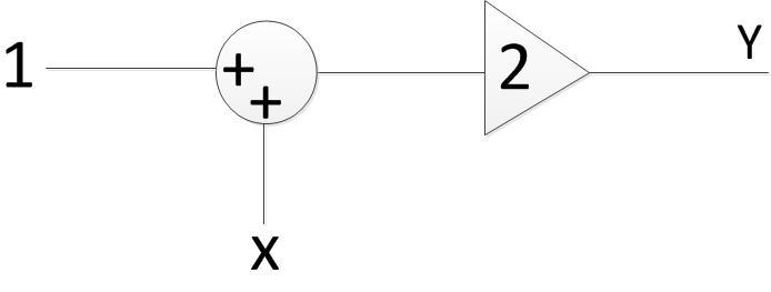

For now I will be focusing on theory. What I'm trying to do is abstracting away all the physical details of circuits. I think the book: "Foundations of Analog and Digital Electronics" takes this approach, which is very interesting.
Lets say two op-amp's are connected together so that the output of one is the input of the other, or maybe in parallel, to figure out the outcome of the circuit do I need to analyze it as a whole? or can I analyze the outcome of each op-amp and then combine the results based on how they are connected?
An algorithm/programming analogy is calling functions in an algorithm. I could either do it both ways, have no subroutines just one function, or break it down into several functions that are made of same code chunks of the main algorithm...
THe analogy isn't perfect, because passing data between functions doesn't have anything that corresponds to "input and output impedance". If you calculate a value, if doesn't matter if you use it as input to one function call or 1,000,000. On the other hand if an electronic circuit works fine with sub-circuit A passing "data" (in the form of electrical signals) to sub-circuit B, It probably won't work the same way if you connect 10 copies of B to A, let alone 1,000,000 copies.
Of course it is often a good idea to design sub-circuits to minimize the (unwanted) interactions between them, but you can never completely eliminate them.
But let's assume the signal is magnified before passing it to another sub-circuit so that it stays the same for all stages. Besides passing a value to 1,000,000 functions definitely affect performance, which is somehow analogous to impedance in this scenario.
So my question is, let alone physical properties which affect both the running of algorithms and signals, can we do the same compose-decompose in terms of functionality?

They are giving you the basic building blocks and showing you how the parts work together. They are not teaching you how to build a radio or computer. You need more specialized textbooks to learn about things like that, or you need to sit down with a pencil and paper and try to design it with the building blocks you have.
Say I want to perform the mathematical operation y(x) = 2(x + 1). I now need to find an analog of this function in electronics. As a designer, you choose how to represent this function with the model tools you have, ie KVL, KCL, ohm's law, and all of the other relationships you have from circuit theory.
I could first draw a block diagram of the process. If you are not familiar with the block diagrams, then that might be a helpful tool for you to learn. It is a graphical model of the mathematical function.
From that block diagram, I see I have 2 values that I'm adding, then I am multiplying the sum by 2, and the output is my function y(x). From that block diagram, I will pick out circuits that I know can do each of the different functions and connect them input to output just as I see in the block diagram.
I think you should keep studying your books, but you should also pick something to design, and you can build it with real components or in a free simulator like LTSpice. You could try to design a circuit that implements the function y(x) = 2(x + 1) for example. If you have question how to do that, you should ask about that specifically. Searching for a universal mathematical approach like a computer science algorithmic approach to designing circuits will be very unhelpful.
One last thing on that. When people learn to code their first programs, do they learn it from a purely computer science, algorithm approach? I think the common way is to learn the language syntax, programming rules, and basic program structures. They don't teach high level software architecture or turing machines to someone just learning to write their first "Hello World" program. Similarly, people aren't taught all of the scales, music notation, and music theory before they are taught how to sing a song or play a few chords in succession on a guitar. So, I think your goal for a computer science approach to circuit design is not going to get you very far, and you are better off playing around with the ideas in the book and looking at other people's designs and taking on some projects to see how circuit design works. One of the most fun parts of electronics is being creative (and appreciating the creativity of others), rather than following a strict algorithm.

Seems the idea is very possible using amplifier circuits but what about filter? Can we design filters the same way. For instance I want to create a filter (active or passive) that passes, for example, the given signal:
f(x) = e^sin(2x) + e^cos(4x) - 2
And I want to generate this signal too. HOW?
If we follow the same simple analog calculator method you mentioned, two questions arise:
1) Where can I find the mapping of circuit/component to math function?
2) Is algebraic addition in math always correspond to connecting any type of circuits/components (output-input cascading) in series?
