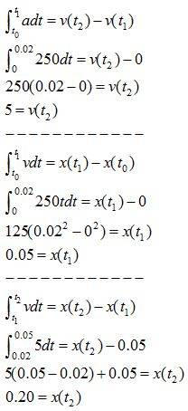

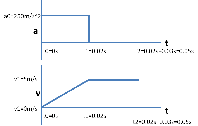

Because I am such an awesome guy (and still waiting for my question to be answered), I decided to graphically show how I did this problem without using the kinematic equations (I hate those equations).

For the graphs, I used Powerpoint. It took a long time though. Next time I'll probably use Solidworks or Autocad, which is a complete overkill but it'll get the job done much, much quicker. For the text, I used MathType. I agree it is a simple kinematics problem, but I was just offering another approach :wink: You will learn calculus based physics in college if you're an engineering or physics major like I am.
