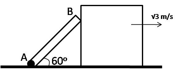

A rod AB is shown in figure. End A of the rod is fixed on the ground. Block is moving with velocity √3 m/s towards right. The velocity of end B when rod makes an angle of 60o with the ground.
I assumed that at any instant the distance of A from block is x and distance of B from ground is y. The length of rod is l.
l^2=x^2+y^2
Differentiating with respect to time.
0=2x(dx/dt)+2y(dy/dt)
y=xtan(60o)
dx/dt=√3 m/s
Solving, i get
(dy/dt)=-3 m/s
But that's not correct, the answer says its 2 m/s. I don't seem to get where i am wrong.
Any help is appreciated. :smile:
Thanks!
Hi Pranav! :smile:
Pranav-Arora said:
y=xtan(60o)
dx/dt=√3 m/s
Solving, i get
(dy/dt)=-3 m/s
Are you sure about that step?
Recheck your solving,
[tex]0 = 2x\sqrt{3} + 2\sqrt{3} x \frac{dy}{dt}[/tex]
Infinitum said:
Hi Pranav! :smile:
[tex]0 = 2x\sqrt{3} + 2\sqrt 3 x \frac{dy}{dt}[/tex]
Oh yes, sorry, my mistake, i wrote tan60=1/√3. :tongue:
But now i get (dy/dt)=-1.
Yes. That's correct. So, what's the velocity of the end B of the rod now?
Isn't (dy/dt) the velocity of the end B?
That is the vertical component of B's velocity :wink:
Ah i get it, thanks for the help Infinitum!
