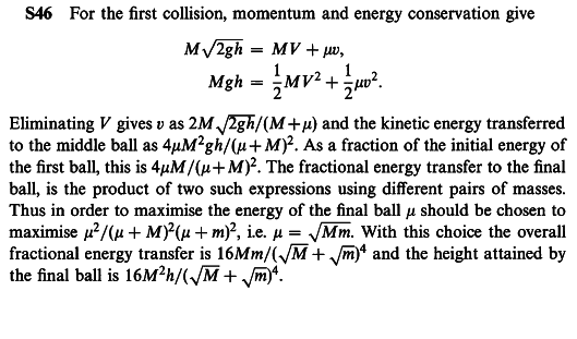

    I've found a solution
    What sorcery did it do to get n = √(Mm)??

    Note that the equation [itex]H = 16h\frac{M^{2}n^{2}}{(M+n)^{2}(m+n)^{2}} [/itex] can be written as $$H = 16hM^2\left(\frac{n}{(M+n)(m+n)}\right)^2$$
    H will be maximum when the expression ##\frac{n}{(M+n)(m+n)}## is a maximum. So, you just need to maximize the function $$f(n) = \frac{n}{(M+n)(m+n)}$$
  7. Sep 27, 2014 #6
    Oh, thanks, TSny, I didn't see the reply. I got it
