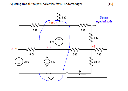

Our lecturer gave us the question as part of an assignment but I'm not to sure if my approach and answer is correct. I attempted it using a supernode as shown in the picture below:

Note that the supernode you've identified is not an essential node -- it's potential is "fixed" by the controlled voltage source tied to the reference node. So you shouldn't write a node equation for it. In fact, there's only one essential node in the whole circuit!
Node v1 is the only essential node.
In your workings you combined the parallel resistors 5||3 at v1. You could also combine the other two 5 and 3 Ohm resistors. Since they are series-connected in a branch, their junction is not an essential node.
Write the node equation for node v1, the only essential node.

No, once again you're trying to write a node equation for the supernode which isn't an essential node. Do NOT write a node equation for a node tied to the reference node by a voltage source. Such a node is only an extension of the reference node, and we do not write an equation for the reference node.
Write only a node equation for the node v1 that I pointed out (post #2). It's the only essential node in the circuit.
