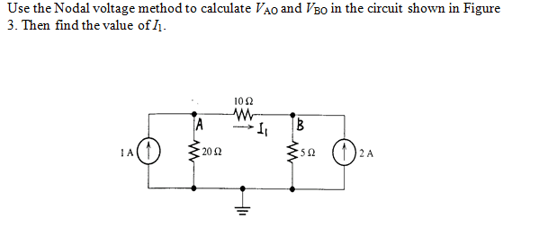

The answer i got for V_ao = 14.285 V, V_bo = 11.428 V, I_1 = 0.285 A
and I'm not sure if the answers are right, can someone please confirm.
Thanks in advance.
Thanks in advance.
Your results look fine, but whether you arrived at them by the appropriate method is unknown as you haven't shown any workings.
