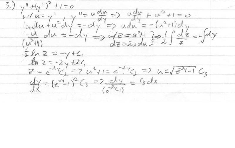

Solve the given differential equation by using the substitution u=y'
y''+(y')2+1=0
If I got to this last integral correctly, I don't know how to solve it. I'm thinking I didn't get to that step correctly.. But I can't find my mistake..
Your work is absolutely correct, you just missed a little detail
[tex]\frac{dy}{dx} = (e^{-2y}-1)^{\frac{1}{2}}C_3 \Rightarrow \frac{dy}{\sqrt{(e^{-2y} - 1)}} = C_3 dx[/tex]
You forgot the square root in the left side of the last equation
[tex]\frac{dy}{\sqrt{(e^{-2y} - 1)}} = C_3 dx[/tex]
I believe you can take it from here right?
Hint: Trig substitution.
Hey thanks for replying Je m'appelle. I'm a little rusty on trig substitution. I know how to evaluate the normal three with x2 as the function but I don't remember how to handle e-x (or -y) function in that case..
And thanks for noting I didn't use the sqrt, sometimes I forget and move on with that mistake :/. I need to train new habits lol.

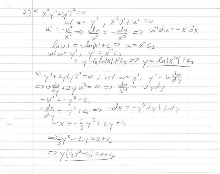

Ok.. So I went on to the next problem and I can't complete it either..
#5) x2y''+(y')2=0
disregard #7, I'm finishing that one up..
Use [tex]v=e^{-y}[/tex] and rewrite
As
[tex]-\frac{dv}{v\sqrt{(v^2 - 1)}} = C_3dx[/tex]
Where
[tex]ln(v) = -y[/tex]
[tex]\frac{-dv}{v} = dy[/tex]
And remember that
[tex]\int \frac{dx}{x\sqrt{x^2 - 1}} = arcsec|x| + C[/tex]
So back to our equation, and using the above we'll get to
[tex]arcsec|v| + C = -C_3x[/tex]
[tex]v = sec(C_3x) [/tex]
[tex]e^{-y} = sec(C_3x)[/tex]
[tex]y = -ln(sec(C_3x)) [/tex]
Now find out [tex]C_3[/tex] by replacing y back into the original differential equation.
Your work is OK up to this point
[tex]\frac{-1}{u} = \frac{1}{x} + c_1 [/tex]
Now replace [tex]u = \frac{dy}{dx}[/tex] and rewrite it as
[tex]\frac{-dx}{dy} = \frac{1}{x} + c_1 [/tex]
[tex](\frac{1}{x} + c_1 )dx = -dy [/tex]
Integrate both sides
[tex]\int (\frac{1}{x} + c_1)dx = -\int dy \Rightarrow \int \frac{1}{x} \ dx + \int c_1 \ dx = -\int dy[/tex]
And work it out from here.
So how does this look? These two problems are the same 5 and 7 posted above. a->5, b->7
