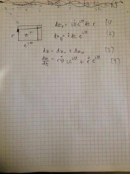

Yeah I can see that. (I'm sorry if I'm being frustrating). Here's my proof for why the first time derivative produces the actual radial and tangential components. I hope this clears up what the actual question I'm asking is.
Z is the area of the square enclosed by sides e^(itheta) and r. dz is the sum of the rectangle above and the rectangle on the right. The square on the corner is ignored because its a double differential. (This is how I've seen the product rule been proven, btw).
Now equation (1) tells me how z changes as r is kept constant and I'm just changing e^(itheta) which is equivalent to a rotation on the complex plane. Equation (2) tells me how z changes as theta or e^(itheta) is kept constant, which is equivalent to moving radially relative to (0,0i). Equation (3) gives me the total change. I'll bring out dt to be on the bottom of dz and represent the derivative (dz/dt). And there it is, one side of the addition tells me how z changes keeping 'r' constant, and the other how it changes keeping 'theta' constant. Here I can see that the actual "components" do correspond to what I was looking for.
Now this way of doing things will be very tedious as I proceed. I want something general that tells me that the "components" will be what I'm looking for.
I do not think that your diagram is correct. It seems to me that you treat ##e^{i\theta}## as a real number. It is not. Are you familiar with the concept "complex plane" (or the Argand plane)? Look it up. Read again what I said earlier about unit vectors.
Yeah I'm familiar with the complex plane, that's why I feel comfortable with treating e^(itheta) and ie^(itheta) as vectors (and I know they're perpendicular). I think it's not invalid to do this type of diagram because you could work backwards by multiplying dz/dt * dt , and you would get equation (3). In any case, did this show what my actual question is? I'm completely OK with why e^(itheta) and ie^(itheta) are vectors, I just want to know why they produce the correct physical results when you differentiate 'z' . :(
##e^{i\theta}## and ##ie^{i\theta}## are orthogonal unit vectors, radial and transverse, respectively. So their multipliers in the first and second derivatives of ##r e^{i\theta}## are necessarily the radial and transverse components of velocity and acceleration.
I don't agree (and I hope you can prove me wrong), because my view is that those are just numbers that have the unique property that they can be interpreted as vectors. But they are not vectors, they are just numbers.
So my suspicion that you were confusing complex numbers with real numbers was not entirely unfounded. A complex number is not "just a number". It is a pair of real numbers: ##(a, b) = a + ib ##. A 2D vector is also a pair of real numbers. This is why we can represent 2D vectors as complex numbers and vice versa.
I know that it is similar to a vector. A complex number is "just a number" except that isn't necessarily a real number. I see the similarity with a vector, but my question still holds. I argue that it just can't be the same as a vector no matter how similar. I think the "proof" I posted in the image above is something similar to what I'm looking for. Was my point clear in the image I posted? (I'm sorry if I'm being annoying).

Your diagram is perfectly clear. The radial and tangential parts really do come straight out of the chain rule in polar coordinates.
olivermsun: But I think this way of doing things is going to be very tedious when I consider the second derivative. How can I generalise this or make it simpler?
Well, it isn't so bad considering the usefulness of the polar form. Also, once you've derived it, you have the formula in-hand and don't need to do it again. :smile:
