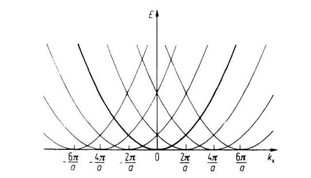

Thanks, DrDu, however I think that I found a way to explicitly see this periodicity. My problem was that I assumed
that free particle solution ##\psi_{\mathbf{k}} = A\exp(i\mathbf{k}\mathbf{r}) + A\exp(i\mathbf{k}\mathbf{r})##
is a special form of a Bloch wave and I couldn't see any periodicity. However if I undestand correctly wavefunction
form ##\psi = \exp(i\mathbf{k}\mathbf{r})u(\mathbf{r})## can only be assumed for a systems with periodic
boundary conditions (Born--Von Karman boundary conditions). And if I plug in ##\psi = \exp(ikx)u(x)## into 1D
free particle Schrodinger equation and apply aditional boundary conditions ##u(0)=u(a),\ u'(0)=u'(a)##,
I get a different sollution
\begin{equation}
\psi(x)=A\underbrace{\exp\left(-i\frac{2\pi}{a}nx\right)}_{u_{n,k}(x)}\exp(ikr)
\end{equation}
which now depends not only on continuous parameter ##\mathbf{k}## but also on discrete integer ##n##. With dispersion relation
\begin{equation}
E_n(k) = \frac{\hbar^2 (k - \frac{2\pi}{a}n)}{2m_e}
\end{equation}
For fixed ##n## I get parabolas which are separated in ##E## vs ##k## graphs by reciprocal latice vectors.
However if I redefine indexes ##n## in such way that:
\begin{equation*}
u^\ast_{k, 1} =
\begin{cases}
u_{k, 1} & \text{if } -2\pi/a \leq k \leq 2\pi/a \\
u_{k + 2\pi/a, 2} & \text{if } 2\pi/a \leq k \leq 4\pi/a \\
\cdots
\end{cases}
\end{equation*}
I can have a periodic solutions:
\begin{equation*}
\psi^{\ast}_{n, k} = \exp(ikx)u^\ast_{k, n}(x) = \psi^{\ast}_{n, k + 2\pi/a}
\end{equation*}
