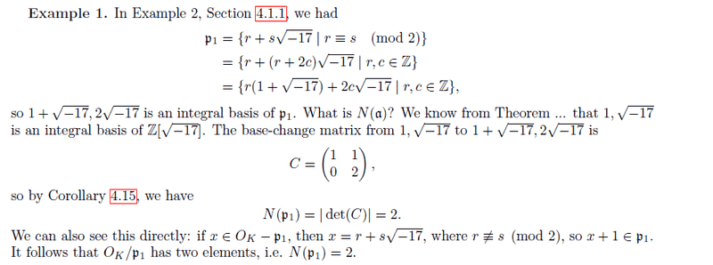

I need to calculate the norm of the ideal
p = (3, 1 - √-5)
All the information I have is that it's a prime ideal.
I managed to calculate the normal of the ideal q = (3, 1 + √-5) (which was 3) by finding a the determinant of a base change matrix by considering an integral basis
Here I'm not sure how to do that (in the other example I managed to show an equivelence relation so that I could find an integral bases)
Here is a similar example with the ideal p1 = (2, 1 + √-17)
Any help appreciated, thanks.
Well, you seem to have been shown two methods: compute a determinant, and compute a residue ring. What difficulty have you had trying to use either method?P.S. when computing the residue ring, I often find it easier to think of your ring as being the quotient of a polynomial ring:
[tex]\begin{align}
\mathbb{Z}[\sqrt{-17}] / (2, 1 + \sqrt{-17}) &\cong
\left( \mathbb{Z}[x] / (x^2 + 17) \right) / (2, 1 + x)
\\ &\cong \mathbb{Z}[x] / (2, 1+x, x^2 + 17)
\\ &\cong \left(\mathbb{Z}[x] / (2)\right) / (1+x, x^2 + 17)
\\ &\cong \cdots\end{align}[/tex]
