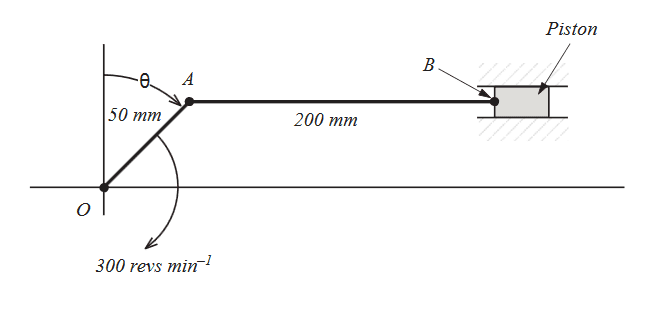

I've been struggling with this question and wondered if anyone could help;
For the mechanism shown determine for the angle θ = 45°:
(I) the velocity of the piston relative to the fixed point O (V bo)
(ii) the angular velocity of AB about point A (Wab)
iii) the acceleration of point B relative to A (Aba)
So far I know that Woa = 300 x 2.pi / 60 = 31.42 rad/s^-1
then Voa = r Woa = 50x10^-3 x 31.42 =1.57ms^-1
now I know that I have to use velocity diagrams to calculate Vbo but I'm just confused about how to do it and also how to know what direction each of the velocities are in, this has been stressing me out for a while so any help would be appreciated!

Break the velocity of point A into horizontal and vertical components. How does each of these affect the velocity of B?
thanks for your reply haruspex, I'm not sure how to break it up into horizontal and vertical components I've really hit a blank!
I thought that the tangential velocity was the value Voa, the length of the arm multiplied by its angular velocity?

You have found the speed, and you know the direction. Do you not know how to find the component of a vector in another direction?

Do you mean using V (vertical) = V Sinθ and V (Horizonal) = V Cosθ to calculate the vertical and horizontal components?
Yes.
So V = 1.57 Sin(45) = 1.11 vertical and]
V = 1.57 Cos(45) =1.11 Horizontally,
Assuming that B can only move horizontally then it would have the same velocity as Vao horizontal which = 1.11ms-1, then using this data I could find Wab and the acceleration, am I right in thinking B moves horizontally to A?

Yes, its instantaneous motion is just that horizontal component.
OK I'm starting to get my head around it now thanks a lot for the help!

so the crank rotates at 300 revs a min and so the rads is 31.42 and the velocity of the crank is 1.57 meters. so using your suggestion of how to work out tangential velocity of vertical and horizontal
( i take it that is for the crank not for the link ab)
now i can't seem to work out how to work out (velocity of ab)
and the acceleration either so if you could give me little help and push me in the right direction that would be great

If A is moving towards B faster than B is moving away from A, what will happen to the distance between them?
ok i understand that now but how do i draw this
if i was i was to draw a line perpendicular to the crank at 90 degrees that would be end up at 135 degrees sort of. as it must travel trough O and the connecting rod also perpendicular but it must travel trough A but i am unable draw it like that it does not work. could you help

Am I making this more difficult for myself by looking at the slider crank mechanism examples online as none are the same and they work out the velocity of other vectors by drawing the velocity Diagram
Part a says
(I)Work out the velocity of piston relative to O (VBO)
(ii) angular velocity of link ab about a
(iii) the acceleration of point relative to a
Below the picture it say part
(b) determine the value of the angle
(Measured from vertical) when:
(i) the velocity of point B = 0
(ii) the angular velocity of link AB a maximum.
(c) What is the maximum angular
So the velocity of vbo is 1.11 m/s and the velocity of link an is 1.11 m/s
And velocity of link oa is 1.57 m/s
Or is this wrong
And how do I work out part b and c
Thanks
The velocity of point A is 1.57m/s. As I wrote in post #13, other parts of the link have different velocities.
For aii), you are asked for the angular velocity of point A about point B. What component of A's linear velocity is relevant to that?
