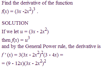

This is an example I found online. I know how to get to this:
, but why is 3-4x brought into the problem? sorry for the newbie questions tonight but my notes from class don't really cover the material very well, thanks.

[tex]f(x)=(x-3x^2)^n[/tex] <-example
bring the power down, subtract it by 1, then do a "chain" of the base and take it's derivative
[tex]f'(x)=n(x-3x^2)^{n-1}(x-2\times3x^{2-1})[/tex] <-example
[tex]f(x)=(3x-2x^2)^3[/tex]
[tex]f'(x)=3(3x-2x^2)^2(3-4x)[/tex]
[tex]f'(x)=(9-12x)(3x-2x^2)^2[/tex]

As rocophysics has shown, it is just the chain rule. The way I learned the chain rule was qualitatively (through words) and it helped me out.
It may seem a little "wordy at first", but it can help if you say it out as you actually do it.
If you have a composite of functions, that is an "outside function" and an "inside function"---->in this case, the cubic function is the "outer" and the quadratic in the parenthesis is the inside----->
then the derivative of the composite function is:
(the derivative of the "outside function", with the "inside function" as its argument) times (the derivative of the "inside function")
...and you can keep on applying this for any number of functions within a composite function. Just keep working from the outside to the inside.

[tex]\frac{d}{dx} f(g(x)) = f'(g(x))*g'(x)[/tex]
That's why you get 3-4x
