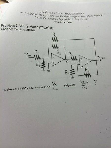

What are the voltage ratios in an op amp circuit?
In summary, the conversation revolves around finding the voltage ratios for ideal opamps with infinite gain and no current draw. The speaker correctly identifies that R2 and R5 are not involved in the analysis for the same reasons. However, a new attempt is needed with R5 replaced with a wire. The conversation ends with the speaker finding an algebra error in their calculation and correcting it, with the assurance that they are now good to go.
gfd43tg
950
50
I have to find both of the voltage ratios. This is just ugly algebra. Here is what I came up with, and was wondering if I was correct.
Thanks

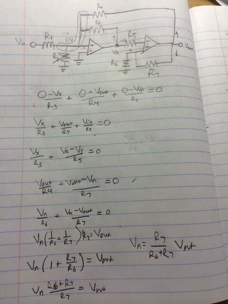

If the opamps are ideal, they have infinite gain and their inputs draw no current.
You correctly saw that this means R2 is not involved in the analysis, but you failed to notice that R5 is not involved for the same reasons.
You'll need to redo your work with R5 replaced with a wire; no R5, in other words.

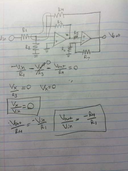

Is it really that easy?

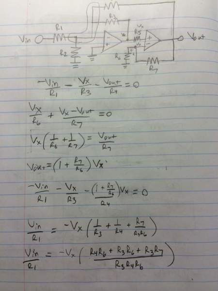

Edit: Wait a minute, I remember the professor saying to never do KCL at the output of an op-amp, I will redo this.
Ok here is my next attempt hopefully it's right
I found an algebra error in my Vout/Vin and fixed it
You're good to go!
