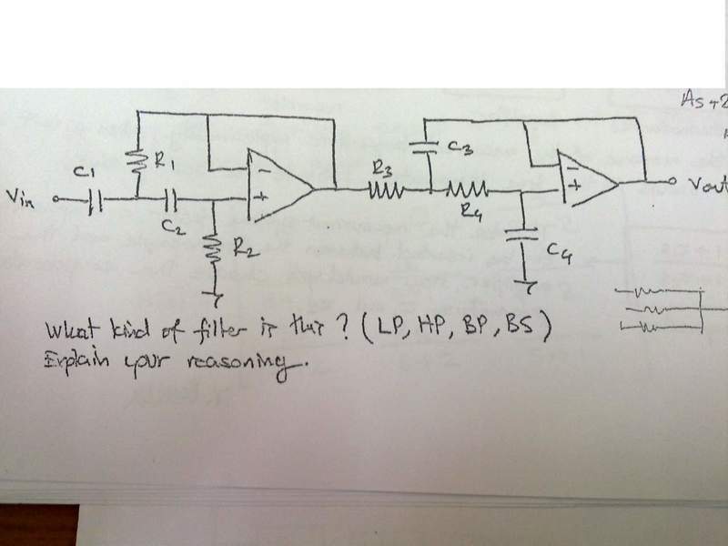

orhanli1
solving op-amp questions
Values of resistors and capacitors
Don't know.
I want your helps.
Thanks

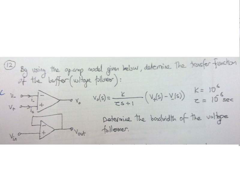

i solved first question
in second i don't understand something
i think the model is low pass filter and i should find gain=k/(tau*s+1) but i can't find a value because of s in equation.
and it is not my homework.
Thanks again

What transfer function do you get for the first stage? What transfer function do you get for the 2nd stage?
sorry i wrote wrong i solved second.
I have a question about the first question.
What is your question? What is that transfer function? It has a basic characteristic. What happens when you connect the opamp in the follower configuration? What is its overall transfer function with that feedback?
