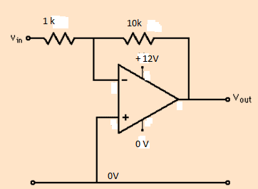

I am working on a circuit with someone and our op-amps keep railing. Even when just working with the op-amp, on its own, with an inverting configuration in negative feedback, everything rails. From my understanding, there should be a gain equal to the feedbak resistance divided by the input resistance, but I am not seeing this. It always rails. Does anyone know why it might do this?

Can you post some of your circuit configurations? Which opamp, and what supply rails? If you are using split power supply rails (like +/-12V), what does the output do when you hook up the opamp in a buffer configuration (- input = output) with the + input grounded?

The op-amp is an LM358 with rails at 0 V and 12 V.
With an any sort of input, I am receiving a 10.9 V output.

If you want to use it in single supply operation like that, you will need to use a non-inverting configuration. You are trying to run an inverting amp above ground with positive input voltages? What happens if you set Vin to -0.1V?
With all the lines we have going everywhere, it would be difficult to move things to test at -0.1V, but switching from inverting to non-inverting fixed the problem. Thank you.

The non-inverting input should go to a "virtual ground" made from two identical series resistors connected across the 12 V power source.
The bottom resistor should be bypassed and the + input connected to the 6 V centre point of the two resistors.
4.7 K resistors would be OK as a start.
[PLAIN]http://dl.dropbox.com/u/4222062/opamp%20bias.PNG
If you want the input to include zero volts, there will need to be a negative as well as a positive supply.
This is just because of the internal construction of the opamp. The inputs and output connect to transistors which have voltage drops across them.
